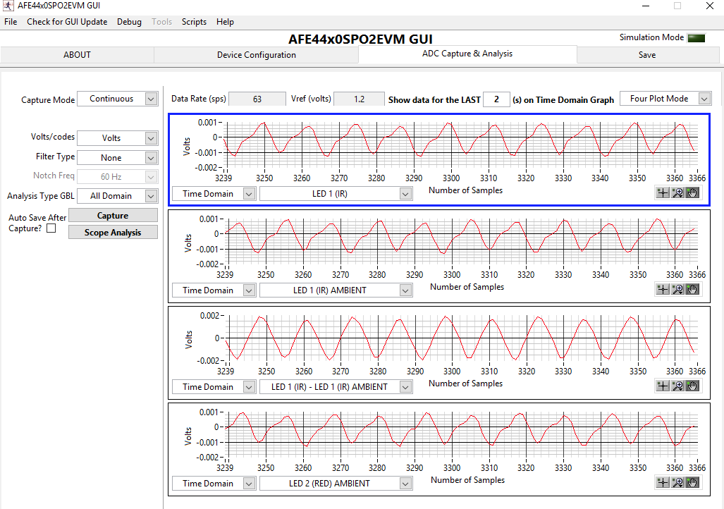

AFE4490: Ambient Noise Phase Offset in Ambient versus LED_ON
Part Number: AFE4490
We have observed a phase offset in the AMBIENT versus LED_ON signal that seems to be due the ambient noise caused by overhead fluorescent lights. The image below shows the measured noise signals without any current driving the LEDs. The frequency of this noise is centered at 5Hz, but seems to depend on sampling rate. When the ambient is subtracted from LED_on, the noise is amplified due to the 180 degree phase offset. The amplitude of this noise below is a few mV, but we've seen the same noise with amplitudes much higher, around 100mV.

Appreciate any help on this issue...
Jason
  • Hi Jason,
    One reason for this kind of behavior is high frequency ambient light. This high frequency signal aliases back as low frequency and that is why its location changes with the sampling frequency.
    LED and AMB phases are sampled at two different time instances , so if the ambient light changes significantly within these instances there are chances that you might get 180 out of phase data  in LED and AMB phase.
    One  way to fix/verify this problem is to change the separation between the sampling phase of LED and AMB. You may have to do couple of hit and trails to find what separation works best for the given ambient light.
