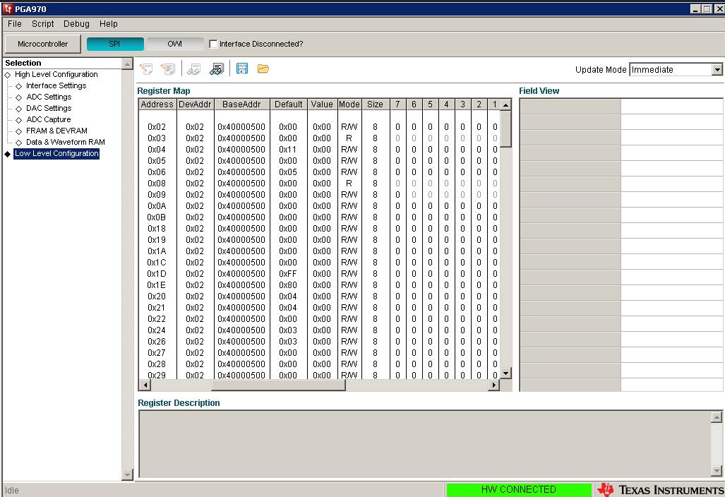

But when the customer clicks the "Read all"t button, the register data of the GUI is all 0. Please check the attach for the connecting of the USB2ANY and
the PGA970EVM, and the GUI register data.

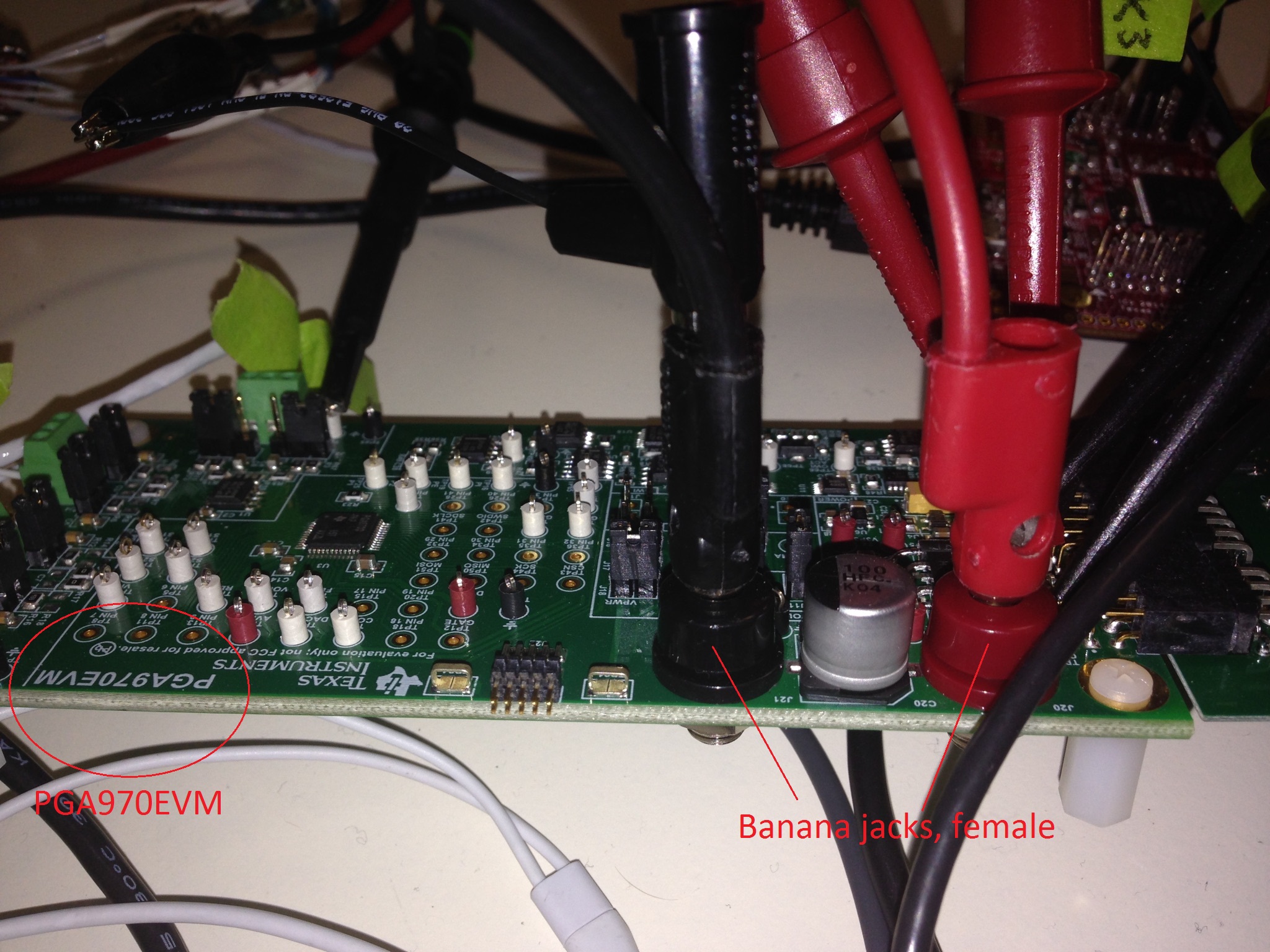

    Thanks for your help. But there is no banana jacks interface on the PGAP70EVM. Do you know this ? The customer needs to connect the external power to J20 and J21.
  • Mickey Zhang said:
    Hi Will,
    Hi Mickey! You show them up in your picture of the board. J20 and J21 are the red and black, female banana jack inputs. If you're referring to the fact male plugs with a cable are not supplied, then I believe you are correct. You will have to order to purchase them separately.
    If the other customer has removed the nuts on the underside of the female sockets, then the female banana jacks can be removed. You could also attach terminal lugs to the underside of the banana jack sockets using a 3/8" nut. Since you say the part isn't there, I'm wondering if the other customer unscrewed the part or whether some boards were shipped without them. That I dont know, any you'd have to check with the other customer. Replacement part is: SPC15354 -> black one, and SPC15363 -> red one. Newark appears to stock both.
    This is my board, currently, with my external connections to J20 and J21. You can see the threading on the female banana jack socket sticking out underneath, where you could use terminal lugs to connect. I think the resolution is high enough that you should be able to make out the J20 and J21 silk screen marks, and the

    Case 1 ,so do I;
    Case 2 ,i am ok, whether if external power connect, HW CONNECT is OK. My computer is windows 7.

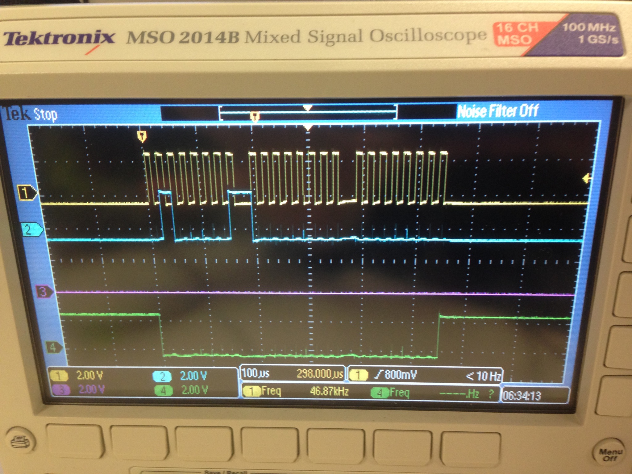

    3. With power not applied to the PGA970EVM but both boards connected, send SPI commands from the USB2ANY over the SPI interface while watching the CSN (chip select), SIMO (Slave in, Master out), SOMI (Slave out, Master in), and SCLK (SPI clock) pins with an oscilloscope. Below is a read command of some register -> select any register in the low level configuration page of the GUI and press the read button located above the register list. You should see something like below, where yellow is the clock, green is the chip select, and cyan is SIMO. Magenta is SOMI, which should not give you a response, as power is not applied to the PGA970EVM.
