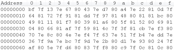

I want to clarify more about ADC data format when use AWR162+DevPack+TSW1400.
When default RadarStudio configures 16 bit complex the order of data should be:
RX1-I sample 0 , RX1-Q sample 0 , RX1-I sample 1 , RX1-Q sample 1 .....Rx1-I sample N-1 , RX1-Q sample N-1 , RX2-I sample 0 , RX2-Q sample 0 ……
Questions:
1. The above data order is correct or not.
2. Is there any header between frames?
3. What is the first sample as following figure? Does they align with big-endian or little-endian?
