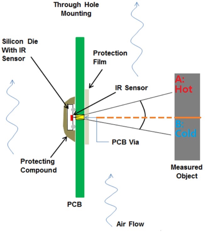

Hi, I'm new with the IR contactless sensors.
From this YouTube demo, it visualizes the Field of View (FOV).
I'm planning to create a custom(FR-4, 1.6mm thick (near 63 mils), 2 layered PCB that uses TMP007. The Through-Hole Mounting Method was the thing I needed.
This is my situation: The center of the via is aligned with a container(measured object)'s center.
- The center of the via is aligned with a container(measured object)'s center.
- This container is partitioned into 2 parts (in half); A and B.
- This container is made of metal and it is black and not polished.
- The distance between the protection film and the container is 10mm.
- For convenience, let's say that the FOV is 20.21°.
After the calibration values are configured, suppose I turned on two machines that
- provide 105°C water continuously to section A
- provide 8°C water continuously to section B
Just like the visualization demo, I want to check whether a single TMP007 can get the temperature differences.
My questions are;
0) If I use one TMP007 like that, can it distinguish that A is hotter than B when mounted as the Through-Hole method?
1) If it is possible, what is the resolution?
If the FOV is 20.21°, can it distinguish temperatures per 1° or less?
Or does this depends on what protection film I use?

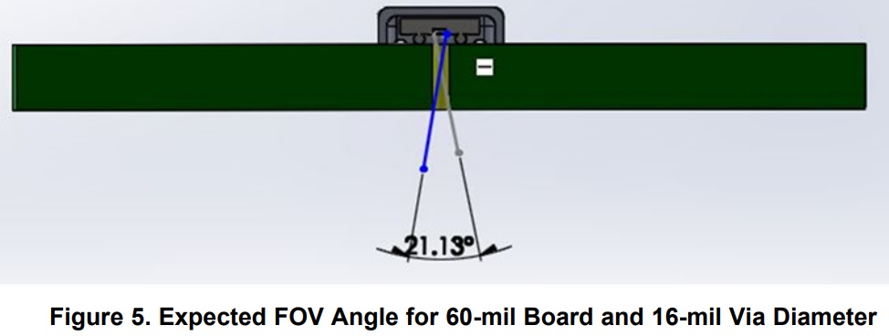

How is the FOV angle calculated?
atan(16 / 60) = 14.931°
What math is used to calculate 21.13°?

  • No, it's not possible to resolve the two object temperatures with one TMP007 device. The device will integrate all the radiation it receives. This means it will report a temperature somewhere in between.

  • Hello, Ren.
    0. I see.
    In this case, the sensor will measure an average temperature value, right?

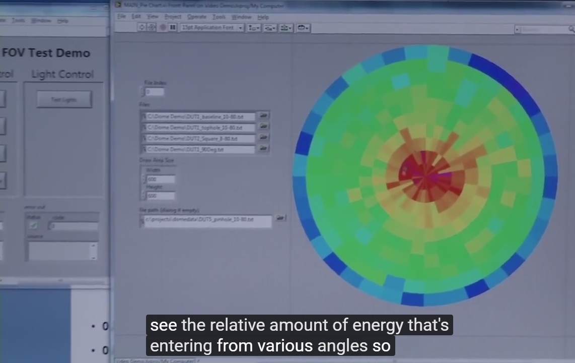

    1. Then, in the YouTube video,
    that FOV demo was quite astonishing. I thought that demo used only one TMP006 sensor.
    Is it not possible to achieve such spectrum data like that with a single TMP00x sensor? I'm curious how that example was demonstrated.
    2) Lastly, can you check my FOV angle question once more, please?
  • There is only one TMP006 in the video. The chart shows relative sensitivity to different angles. You might be looking for an IR Array. There are products like this on the market, but not from TI.
