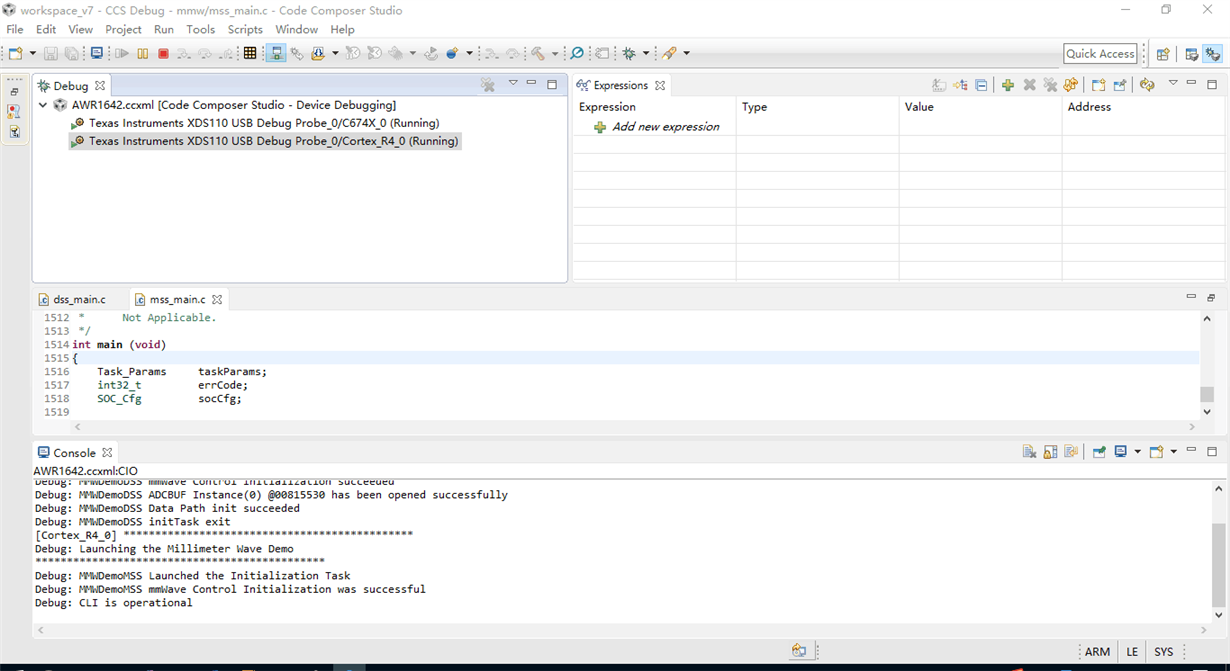

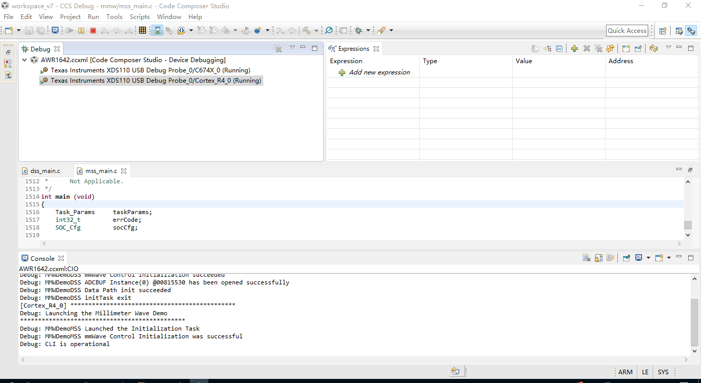

I am trying to capture data using this SDK, and I am trying to follow the instructions as explained in the "MMWAVE SDK User Guide",section 4.3 and "xWR16xx_mmw_user_guide".
I successfully connected the target and respectively loaded program for C674X_0 and Cortex_R4_0, but I can not see anything in CCS Expressions window.
What is the reason for this problem? Thank you in advance.

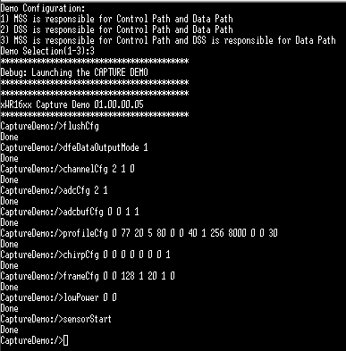

  • Jian,
    Pls open a serial port terminal and select the serial port for User UART COM port and then following the steps in 3. 4. 3. Capture demo for xWR16xx of mmwave_sdk_user_guide.pdf.
  • Thanks, Chris
    I open a serial port terminal by teraterm and send the commands provided in file(capture_demo_script.txt) to the CLI window , but I still can not see the Parameter information.
    The console shows:
    [Cortex_R4_0] Debug: Launched the Demo Initialization Task
    Debug: UART Instance @0800c0a8 has been opened successfully
    Debug: UART Instance @0800c0b4 has been opened successfully

  • Jian,
    You need to add the expression manually.
    Pls kick "+" in Expressions window and add "gCaptureMCB" and check related values.
