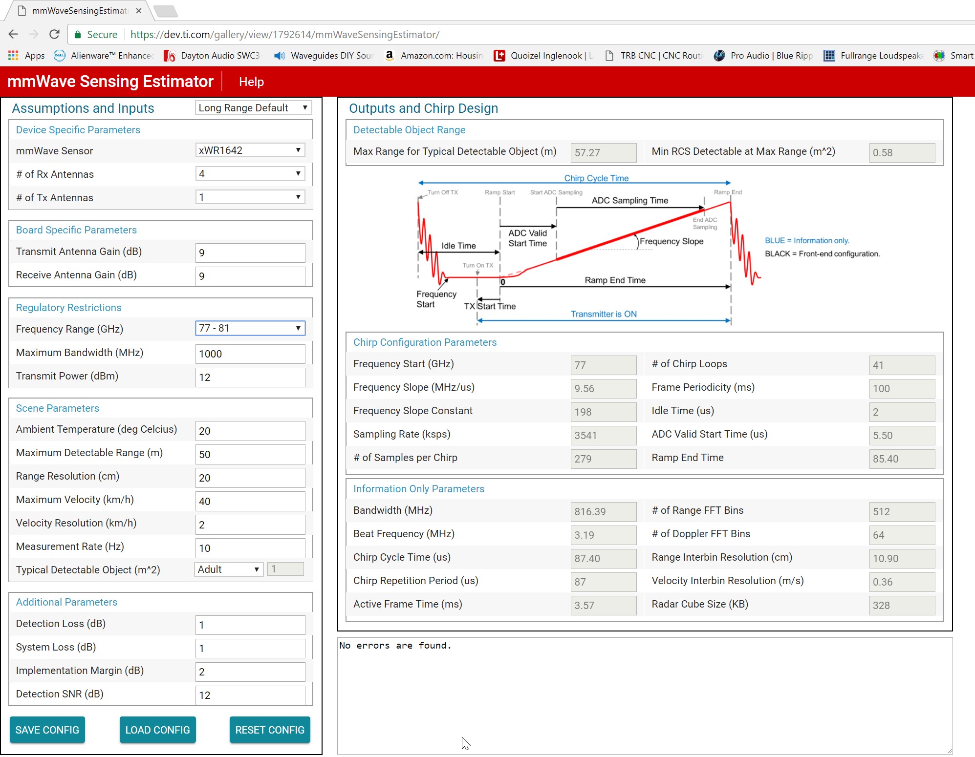

    I have used the mmWave estimator, Long Range default, and modified the engineering parameters to detect a .5RCS object at 50meters.  See attached
    The estimator engineering values can be loaded from the attached .json file.JPG.  The .json file, can be converted to the Visualizer Out of Box demo, by saving the max range Visualizer commands, and modifying the key parameters.   This will be reported in the .cfg file, and visualizer picture.
    I will try these on the EVM and report the results next.   The experiment results will be provided Monday Oct 2.
        "platform": "xWR1642",
        "num_rx": 4,
        "num_tx": 1,
        "tx_gain": 9,
        "rx_gain": 9,
        "frequency_range": "77 - 81",
        "maximum_bandwidth": 1000,
        "tx_power": 12,
        "ambient_temperature_degC": 20,
        "maximum_detectable_range": 50,
        "range_resolution": 20,
        "maximum_velocity_kmph": 40,
        "velocity_resolution_kmph": 2,
        "measurement_rate": 10,
        "typical_detected_object": "Adult",
        "detection_loss": 1,
        "system_loss": 1,
        "implementation_margin": 2,
        "detection_SNR": 12,
        "maximum_radar_cube_size": 768,
        "maximum_RF_bandwidth": 5,
        "maximum_sampling_frequency": 6.25,
        "sensor_maximum_bandwidth": 4000,
        "maximum_allowed_bandwidth": 1000,
        "starting_frequency": 77,
        "maximum_velocity": 11.11111111111111,
        "velocity_resolution": 0.5555555555555556,
        "valid_sweep_bandwidth": 750,
        "idle_time": 2,
        "adc_valid_start_time": 5.6,
        "excess_ramping_time": 1,
        "periodicity": 100,
        "ambient_temperature": 293.15,
        "noise_figure": 16,
        "num_virtual_rx": 4,
        "non_coherent_combining_loss": 2,
        "rcs_value": 1,
        "combined_factor_in_dB": -4,
        "combined_factor_linear": 0.39810717055349726,
        "inter_chirp_time": 8.6,
        "aux_comp_coeff_a": 77375000000,
        "aux_comp_coeff_b": -6080375,
        "chirp_time": 78.58319870759289,
        "ramp_slope_init": 9.544024833994614,
        "ramp_slope_parameter": 198,
        "ramp_slope": 9.559392929077148,
        "aux_comp_T1": 1,
        "maximum_beat_frequency": 3.186464309692383,
        "sampling_frequency": 3.540515899658203,
        "number_of_samples_per_chirp": 279,
        "total_sweep_bandwidth": 816.3919933319091,
        "idle_time_minimum": 2,
        "ramp_end_time": 85.40207515151515,
        "carrier_frequency": 77.0535342338526,
        "aux_comp_T2": 4.5,
        "adc_valid_start_time_2": 5.5,
        "lambda": 3.893397012647324,
        "max_chirp_repetition_period": 88,
        "chirp_repetition_period": 87,
        "num_range_fft_bins": 512,
        "min_num_of_chirp_loops": 41,
        "max_range_for_typical_detectable_object": 57.272540816194095,
        "min_rcs_detectable_at_max_range": 0.580890422042715,
        "num_doppler_fft_bins": 64,
        "active_frame_time": 3.567,
        "range_inter_bin_resolution": 10.8984375,
        "velocity_inter_bin_resolution": 0.3559027777777778,
        "radar_cube_size": 328
