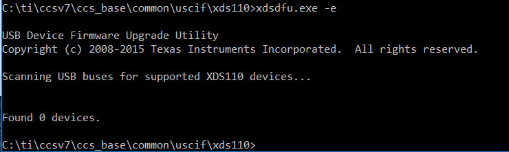

Hi, after I ran a few time the online demo I am not able anymore to detect the device when it is connected to a PC with a usb cable.
When I connect the usb cable nothing happen in the device manager.
I tried also with other PC and OS with the same result. I am using also an AWR1642BOOST board and it is working properly with the same power supply and USB cable.
Can someone suggest some procedure to restore the board or reprogram the XDS110 emulator?
