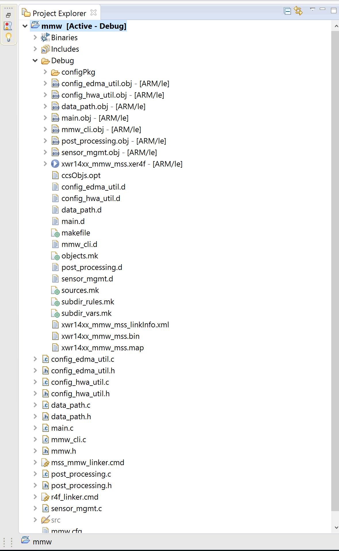

    Thank you. It's works fine. Now assume we do not have these two .bin files to load using the UniFlash on the board.
    How can I convert or generate these .bin files to load on the flash? A picture of the project is shown in the figure:

  • Hello Amin,
    I am assuming you have the SDK 1.05 installed. Inside the C:\ti\mmwave_sdk_01_00_00_05\docs directory, you can find a file called mmwave_sdk_user_guide.pdf.
    Please follow the instructions highlighted in section 4. 4. Developing using SDK, which will explain how to build the binaries. Before doing this, make sure you download and install all of the necessary prerequisites in the mmwave_sdk_release_notes.pdf found in the same directory as the User's Guide.
