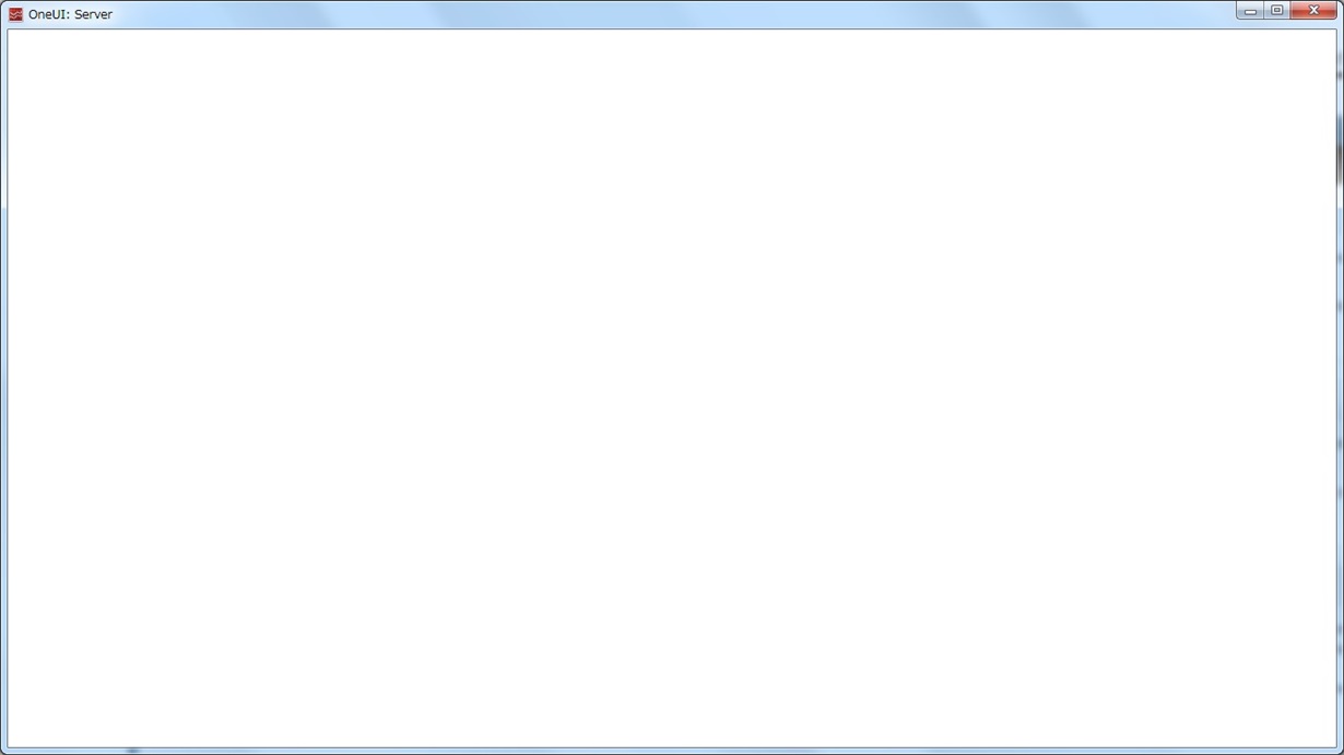

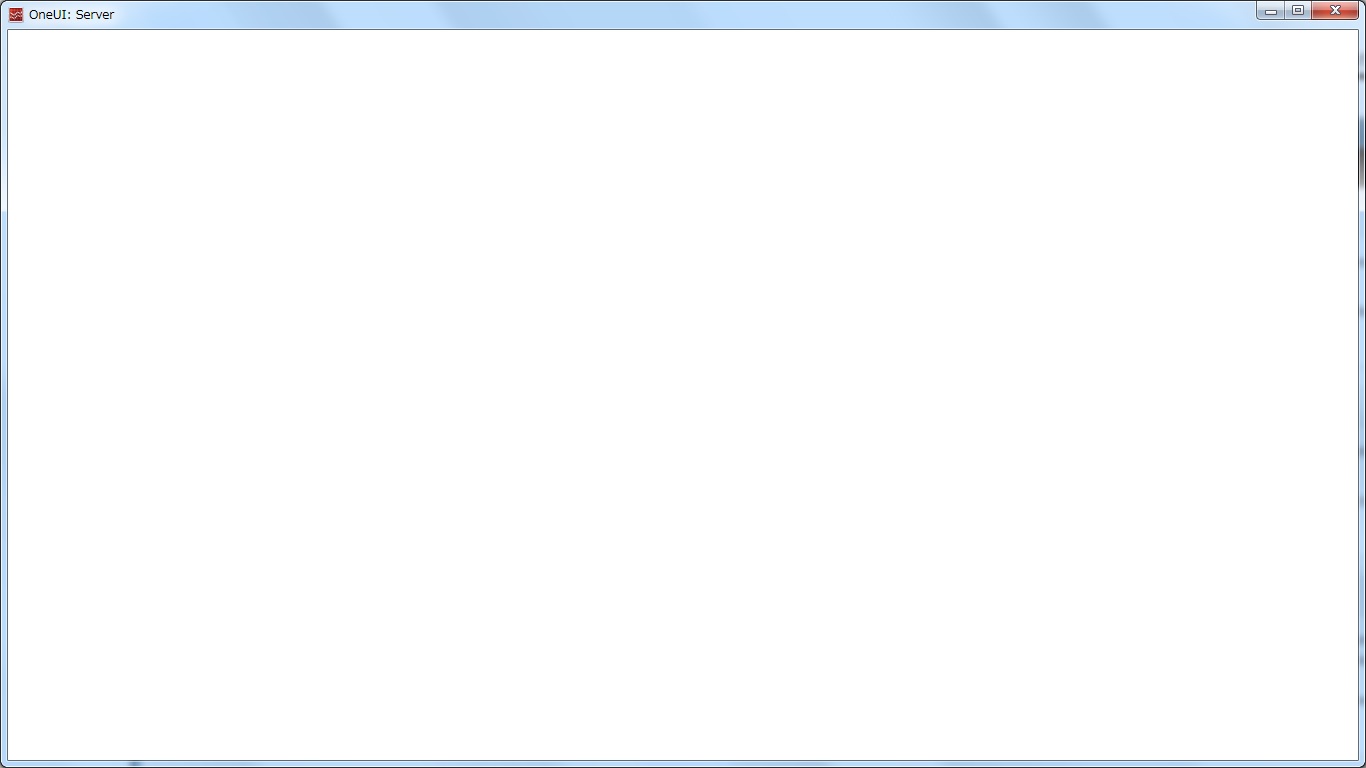

Dear Technical Support Team,
I installed Sensing Solutions EVM GUI, but it doesn't launch.
OneUI shows following and it doesn't proceed.
Does it connect any server? If that, it may affect our fire wall security. Could you share the information of access point?
Could you share the workaround?
■Additional information
PC: Windows7 64bit  or 32bit
Installed file: snoc028c.zip (Sensing Solutions EVM GUI Tool v1.9.2 )
ttd
  • Hi ttd,
    It seems like the GUI installation was unable to copy some of the files in the correct directory.
    Have you tried running the GUI as an administrator? You can in addition navigate to the following location (assuming default install location)
    C:\ti\Sensing Solutions EVM GUI-1.9.2\PC GUI\
    and run nw.exe as an admin.
