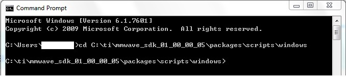

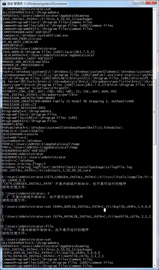

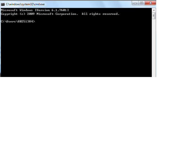

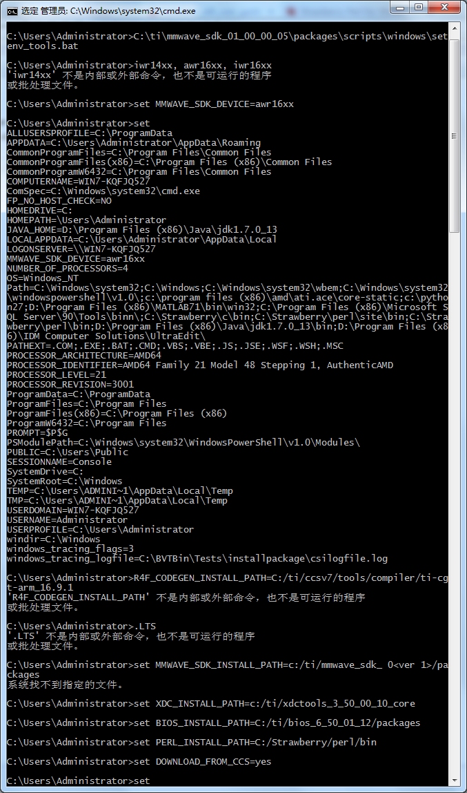

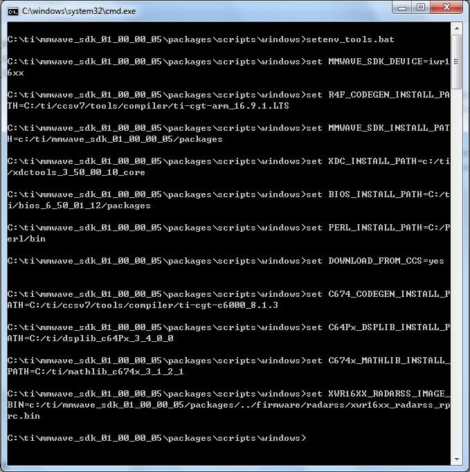

Hi team,
The customer is using IWR1642BOOST. He refers to the 4. 4. 2. Setting up build environment---4. 4. 2. 1. Windows for SDK_User's Guide.
He uses the "cmd" command on his PC. But he occurs an error. Please check the attachment.
Q1: For the  4. 4. 2. Setting up build environment---4. 4. 2. 1. Windows, where is setenv_tools.bat?
It is not in the <mmwave_sdk_<ver> install path>\packages\scripts\windows folder.I cannot find it.
Q2: The customer uses  the "cmd" command on his PC to run. Is he correct?
Q3: How to solve the customer's question? How to complete the 4. 4. 2. 1. Windows step?
Recently, when many customers build environment, they occur the same above the issue. They prefer we can provide some graphs to
understand.
