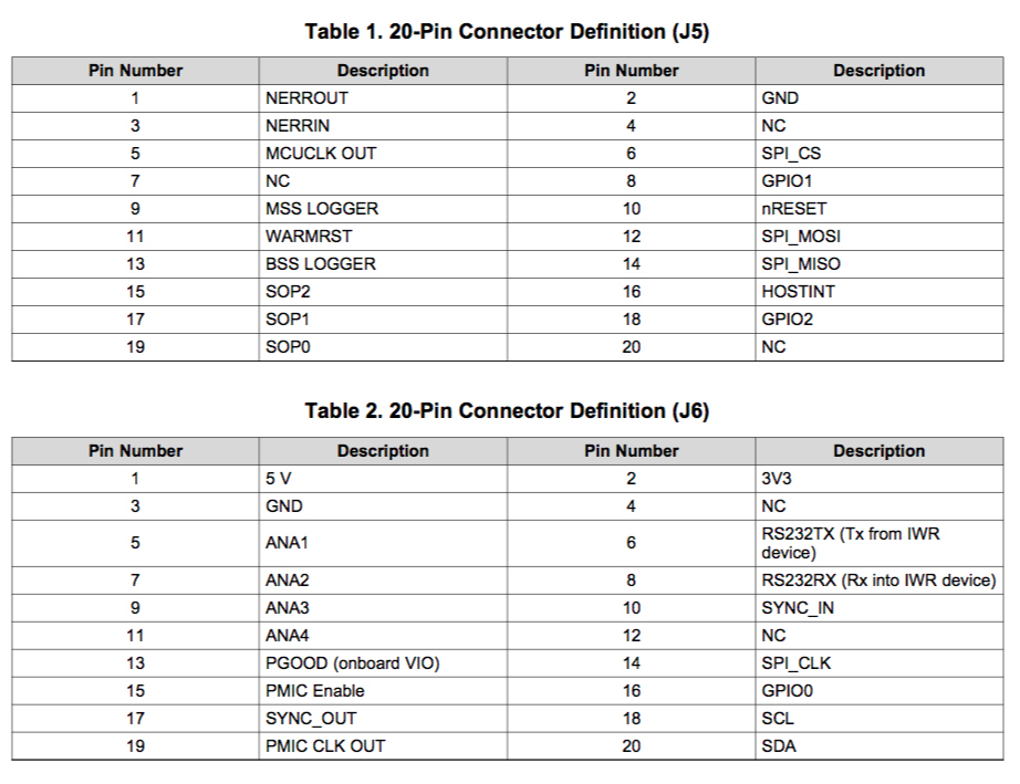

How can I send the range, speed and other information of the targets  that sent to the mmWave_Demo_Visualizer, through UART port? Is there a project to do this?

    Thank you for your help. My goal is send target data to PIN NUMBER #6 TX from IWR (J6 connector).
    Now, I can't find UART port in the project.

  • Hello Amin,
    In the mmWave Demo the object data is sent out using the MSS logger UART. You can access this through pin 9 of jumper J5 by populating resistor R26.

  • Hello Adrian,
    My goal is to receive target data without need a computer USB port and XDS110 driver, for example: reading the target data with simple processor(other launchpad with UART port).
    Thank you.
    Amin
  • Hello Amin,
    You should not have to make any modifications to the code. This is the default UART used to send object data so simply populating the resistor should allow you to access the data.
