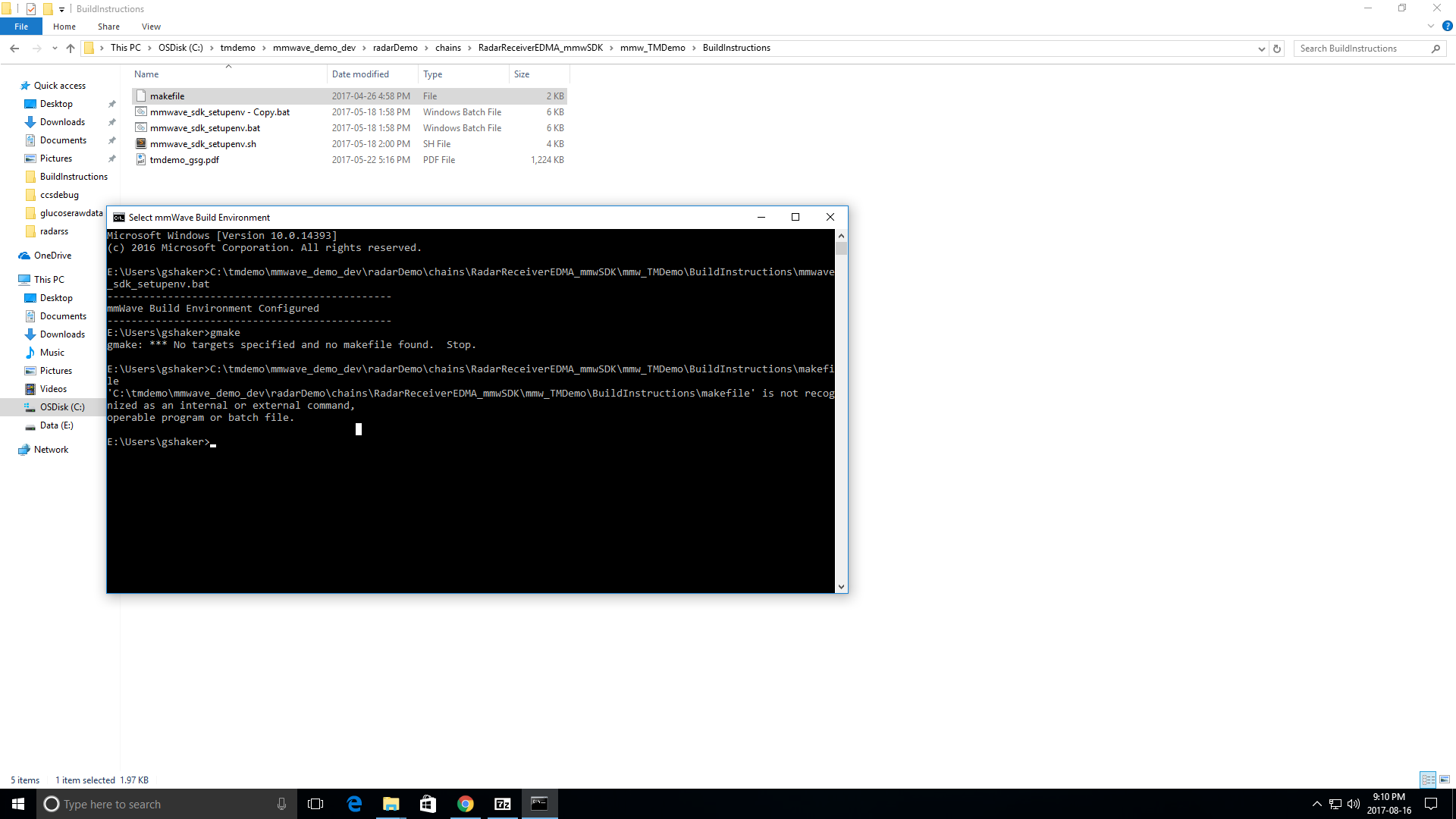

HI i am trying to apply gmake command but it always gives me an error as shown in the screen shot,
kindly advice what am doing wrong and how to apply it correctly in order to continue

Hello Sylvia,
The error seems to be in the setting up the build environment with required tools for the SDK build.
The "MMWAVE-SDK" user guide provides step-by-step instruction to develop using the SDK.
Please follow all the steps in the "Section 4.4 Developing Using SDK " .
This will help you in doing a successful SDK "Demo Example" build.
BR,
Raghu
It was apriblem due to the adminstrative rights on the univ. Laptop.. now it is solved
