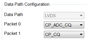

There is below configuration view in the radar studio, currently we know the data format for ADC_ONLY configuration, my customer also want to know the data format for the other packet configuration. We checked the AWR1xx data path programmer's guide, not found the exact information, would u pls help describe the data format for all the packet configuration?

    The support for CP "Chirp Parameters" is available in the device firmware that is available in the MMWAVE-DFP. The details of the CP data format is available  in section 5.14.3 of "AWR1xx_Radar_Interface_Control.pdf ". The customer can use the ADC_CP, CP_ADC mode of operation with the current firmware.
    At this point device firmware does not support the CQ data . This will be made available in the future releases of the MMWAVE-DFP.

    What I want to know is not only the CP/CQ bit format, I want to know the format of the data captured and stored in file C:\ti\mmwave_dfp_00_07_00_04\rf_eval\radarstudio\PostProc\adc_data.bin. Below link described the ADC raw data format for ADC_ONLY, but no description about the format for other configuration with CP/CQ. So would u pls instruct me the data format as below link?
    e2e.ti.com/.../602629
