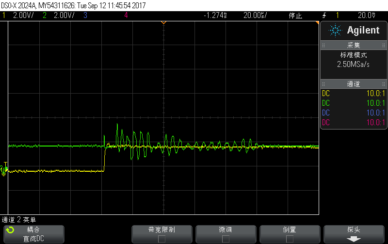

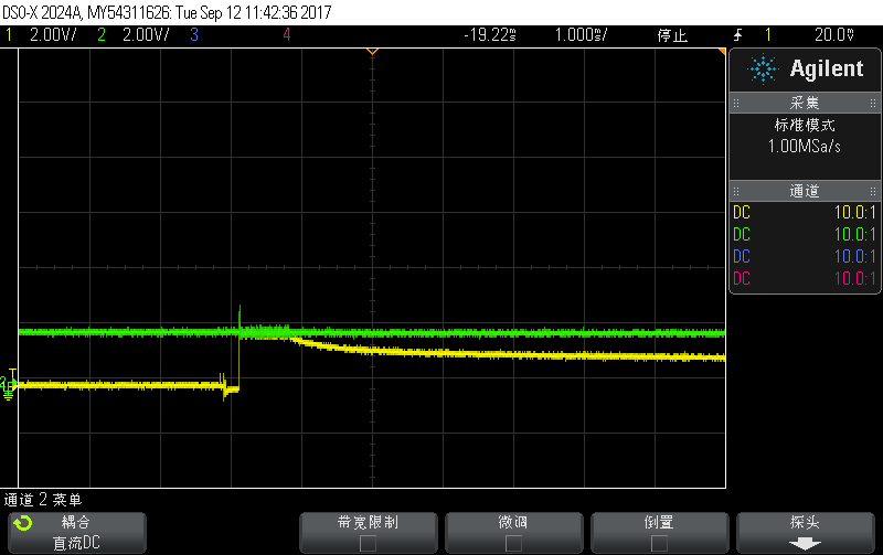

    In view of the above third points,I checked  that there is nothing on the board for R41 and R52. If I have CH1 selected, that should not  be TX1/RX1 in mode 1?And  that even with the transducer disconnected I saw a signal on RX1, the signal is same as that with the transducer connected.

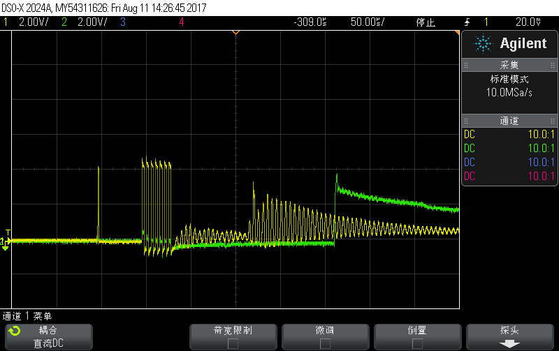

    What I see is as follows with channel 1(TX1/RX1):
    1、With RX ultrasonic transducer connected, there are signals :RX1,COMPIN and  STOP
    2、Without RX ultrasonic transducer connected,there are signals:RX1(the signal is same as 1)  ,but I didn't see COMPIN and STOP signal;
    Without RX1 ultrasonic transducer connected:
    In this picture,yellow-RX2,   green-RX1(I don't understand);
    In this picture,yellow-RX1,   green-COMPIN, no STOP;
    With RX1 ultrasonic transducer connected:
    In this picture,yellow-RX1,   green-COMPIN;
    In this picture,yellow-RX1,   green-STOP;
    In this picture,yellow-COMPIN,   green-STOP.
    I wonder if this waveform is correct,please.
