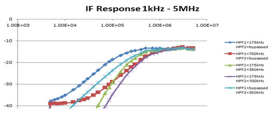

    The radar sensor has different operating modes, and the signal bandwidth is based on the Digital Front End (DFE) output rate.  The signal bandwidth is also limited by the HPF1, HPF2 high pass filter selections in the ProfileCfg.   The green and purple plots in the attached figure show the two lowest HPF filter settings.
    Note: in the graph, we apply more than 40db attenuation to the Rx signal based on the High Pass Filter selection.   The Rx LNA gain adds 24 - 48db, to eachRx.    So the High Pass limit would be based on the air attenuation, and reflection to the antenna.   In the case of measuring close range objects this is one part of the configuration.
