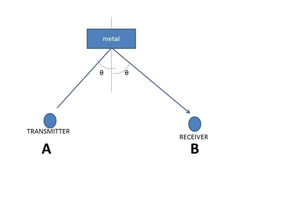

  • Locating objects including metals/cables etc. are applications of mm-wave radar that are known to work.
    Your requirements is additionally to discriminate between cables made of different types of metals. This is something
    we have not tried ourselves, but worth investigating as a new application. Some of my comments below:
    1) If creating the Brags pattern requires changing the angle of attack, then this would require the sensor to move around.
    Is this practical in your case?.
    2) Also the reflected ray that we are interested in might show up at some other location (say B in attached figure). This would not be the same location as the sensor (A) which transmitted the mmwave signal) This would require two sensors and synchronizing them also.

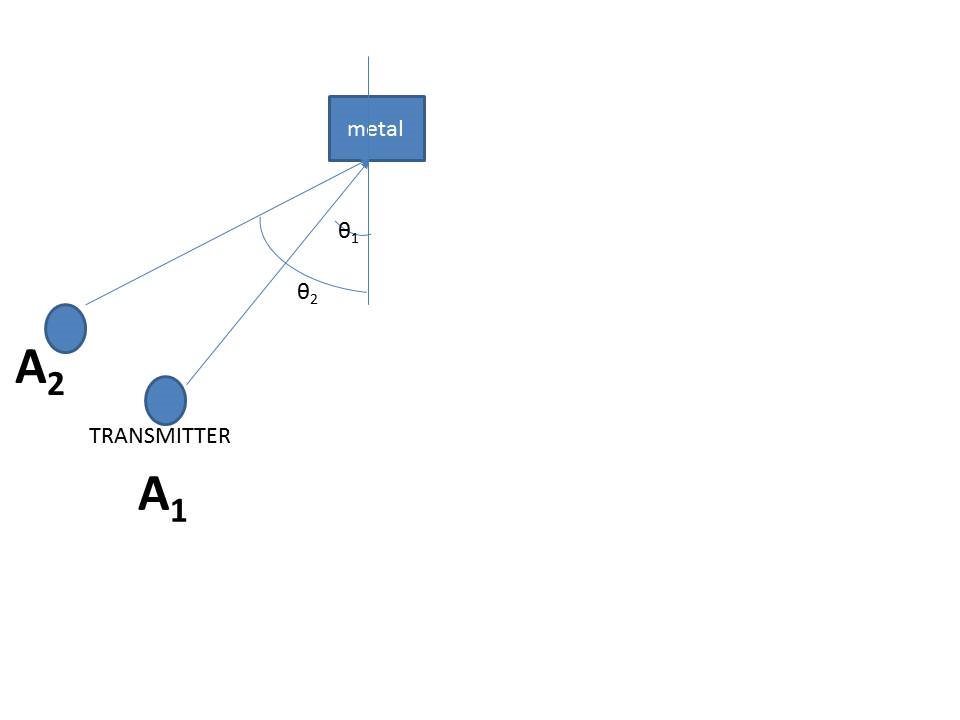

    1) Sensor will be mounted on a robot, but I think you aren't speaking about that. Do you mean having the sensor to oscillate on a mobile on the robot?
    2)Wouldn't that be possible with one radar by wiring board antennas to externals and giving them attack angle?
    If not possible, the solution then would be to have a radar used as transmitter only with an attack angle ThetaTx and a radar used as receiver with a baseline (distance Tx Rx) to be determined?

  • 1) My understanding was that we need to vary the angle of attack to determine the "type of metal".  Is this right? .  Now depending on distance of robot to the cable, changing angle of attack might require changing the senor position (see attached figure, where to change angle of attack from theta1 to theta2, sensor has to move from location A1 to A2.. It depends on what is the variation in the angle of attack that you require for determining the type of metal. Another practical issue I see is that the orientation of the cable is unknown so the angle of attack will be unknown to within constant. Is this a problem.
