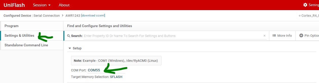

    Please check if the COM port selected is the right COM PORT.
    You can go to the "Settings and Utilities" view and check the COM Port selected.
    You should choose the "XDS110 Class Application/User UART" port for the flashing.

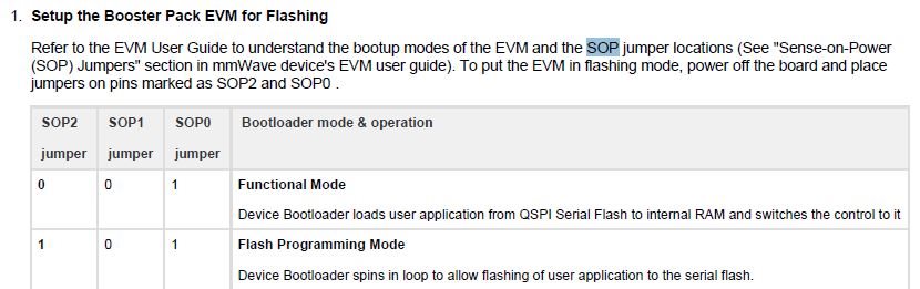

    I am assuming that you already have the right SOP mode settings for flashing( SOP2 and SOP0 jumpers connected).

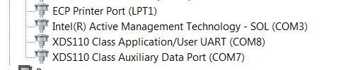

    That is what i was doing i set the COM port the the COM that was assigned as
    "XDS110 Class Application/User UART" which in my case was COM8 (COM7 is assigned to aux data)
    it only once seem to even try to start and then as i mentioned got stuck when i retired it keeps saying it cannot access the COM port - tried restarting the application and power cycling the module but it refuses to communicate with the COM port.

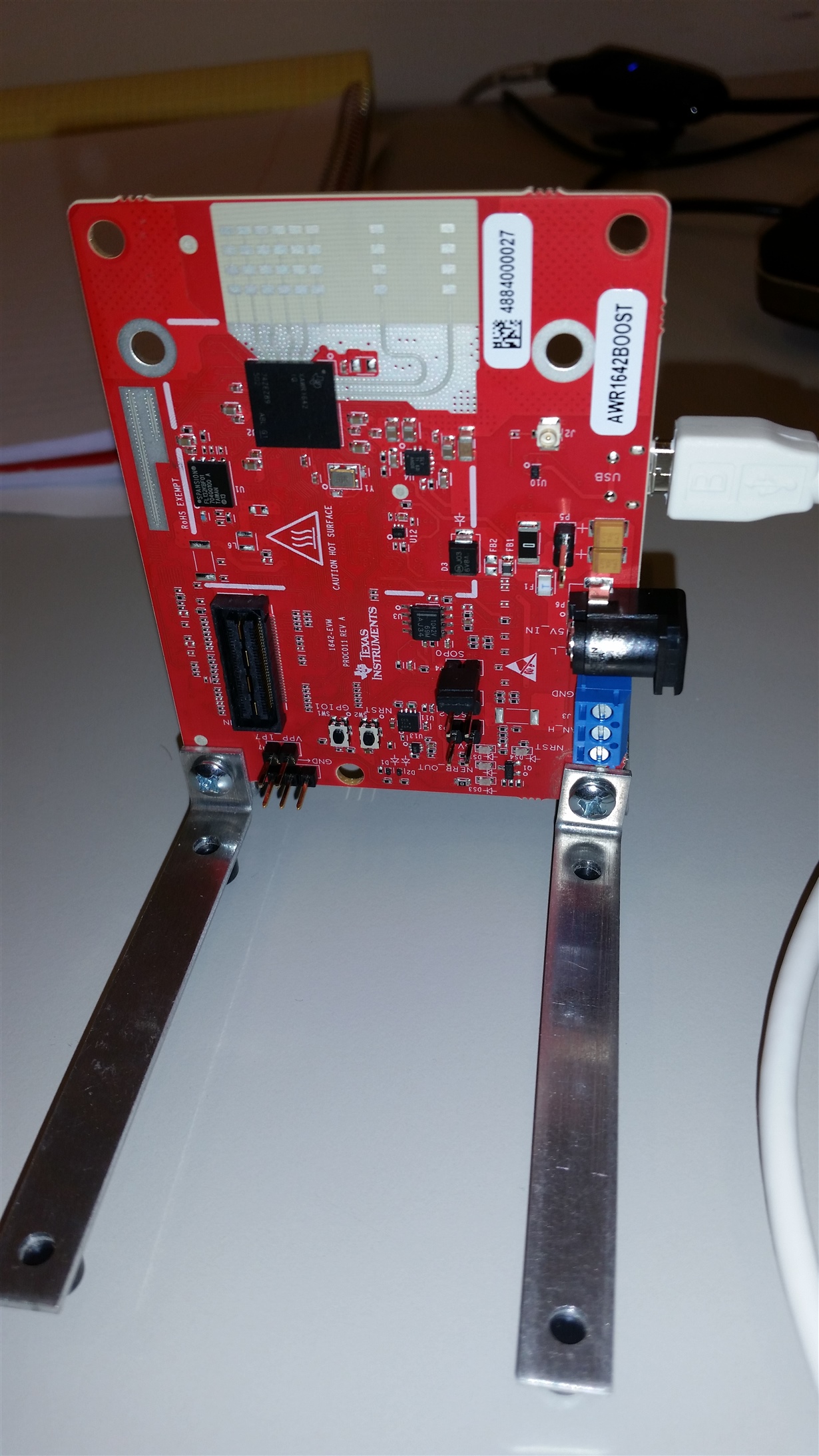

  • Hi Guy,
    Did you try removing the DEVPACK and just use the AWR1642BOOST connected to PC?
    Can you send me the pic of the EVM and the screenshot of the Uniflash error ?
    Raghu

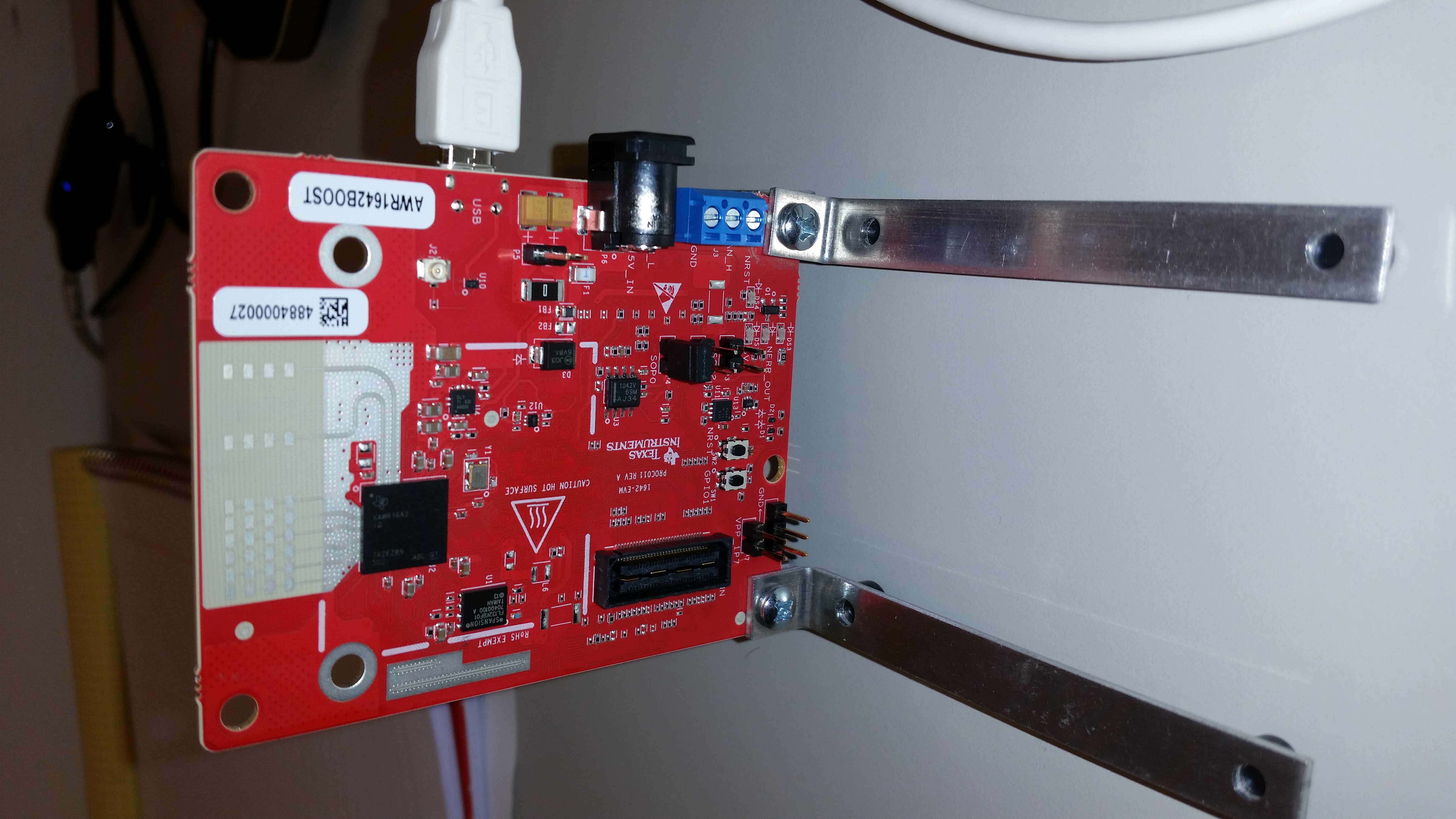

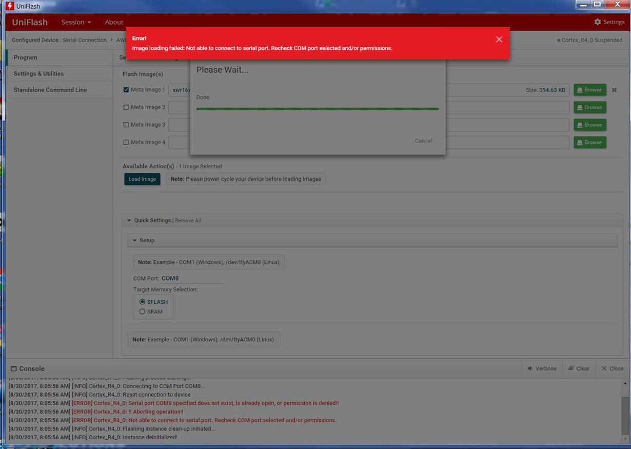

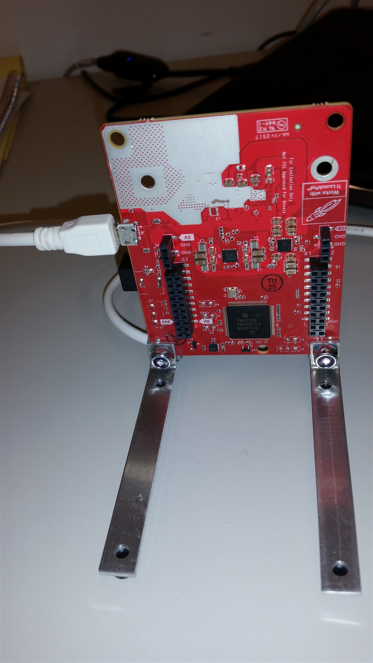

  • Hi i have only one board (AWR1642BOOST) - see pics.
    also attached snapshots of the COM ports and the UniFlash with the error.
  • Hello Guy,

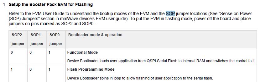

    From looking at your AWR1642BOOST I see that the "P3(SOP2)" is open. You will need to close this during the flashing operation. Use the jumper and close the SOP2 during the flashing.
    Please refer to "Sec 4.1 How to flash an image onto xWR14xx/xWR16xx EVM" in the mmwave SDK User guide.
    Rest of the setup look fine to me.
    Raghu
    Please click the Verify Answer button on this post if it answers your question.
  • Hi,Thanks but the same error remains even after i closed the jumper .
  • Hello Guy,
    This is strange.
    The error snapshot says that COM8 cannot be accessed.
    Are you connected to teraterm/hyperterminal on this port? Or is the RadarStudio connected to this port?
