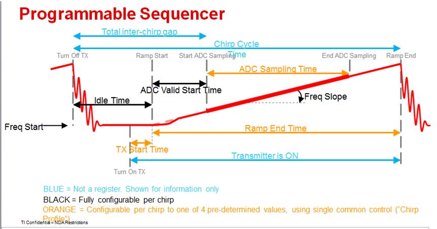

I'm preparing documents for the certification test, and having difficulty in finding the information in the title.
Of course, one antenna radiates inside one chirp period.
My question is;
Does the antenna continue radiation while inter-chirp periods ?
Or, does it stop radiation frequently within micro seconds ?
    We can define when we want to turn ON the TX using the  the profile config parameter "PF_TX_START_ TIME".  Refer to "AWR1xx_Radar_Interface_Control.pdf" in the MMWAVE-DFP.
    Hope this helps your understanding that the TX is turned OFF between the chirps.
    Raghu
