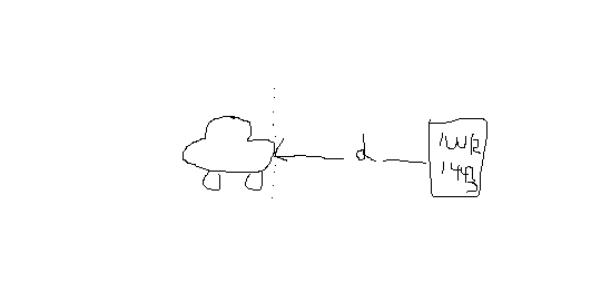

hello i have some problem about mmwave sensor
already i learned TI trainning of 'fundamentals of mmwave sensor'.
i wondering about range estimation. i want show the example about estimate the distance from rader to object
please show me the example about range estimation
ex)
Thank you listening

    So, i want to know about 3types estimation using sample data (ex. The distance (rader to object) is 15mm , The range resolution is  0.5mm)
