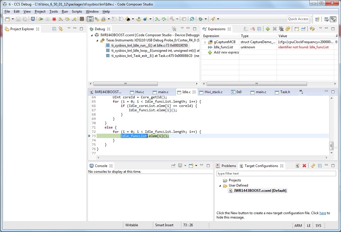

IWR1443BOOST: CCS don’t show SYS/BIOS variables
Part Number: IWR1443BOOST
Other Parts Discussed in Thread: SYSBIOS
I loaded Capture Demo Run->Load->Load Program
CCS don’t show SYS/BIOS variables but shows ones from Capture Demo.
How to see SYS/BIOS variables in CCS expressions view?

  • Hi Gennadii,
    It is strongly recommended to use ROV (Real Time Object View) to look at kernel data structures instead of trying to read RTOS internal data structures directly. ROV interprets the various kernel data structures and therefore it is easier to understand the current state of the RTOS.
    In order to look at the actual data structures directly (without ROV), you will would need to enter the fully qualified variable names in CCS expressions window as discussed in this thread. These can be obtained from the map file. If we take the “Idle_funcList” array for example, the name can be looked up in the map file and the full name “ti_sysbios_knl_Idle_funcList__A” is found.
    Hope that helps.
