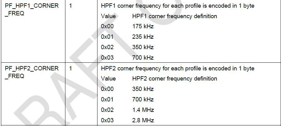

Hi experts,
AS the picture show below,i haven't see any HPF filter:
but there are two options in Radar Studio - Sensor Config show as below;
Q:Where is the HPF in the text?
Thanks!

Hello NanShan,
The HPF1 and HPF2 frequencies are parameters of the profile configuration. This is mentioned in the "AWR1xx_Radar_Interface_Control.pdf".
Also the HPF corner frequencies influence the ADC start time.
Raghu

Hi Raghu,
Thanks for your replies!
Q:I want to know where to physically location of of the HPF?

Hi Raghu,
Could you explain why two HP-filters are used here?
