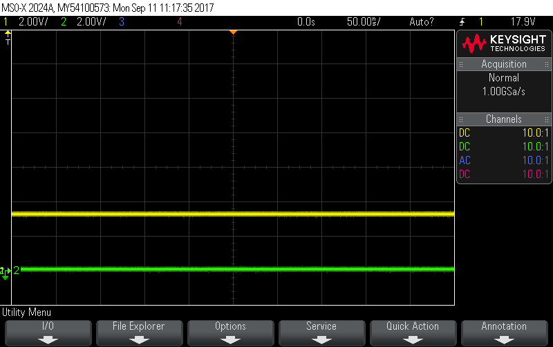

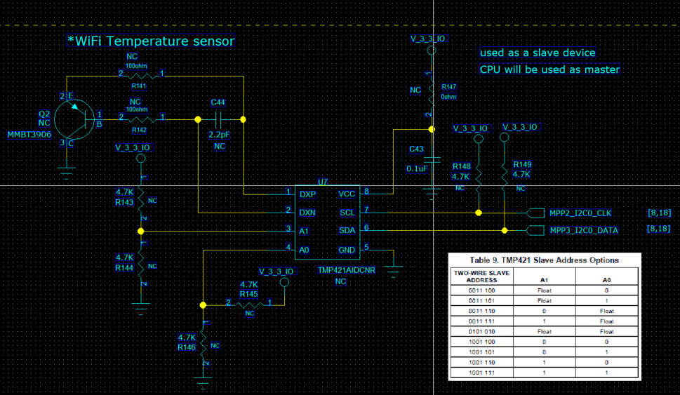

I have faced an error by using TMP421 and it happens when I am using slave address 0x4C (100 1100) with errors below.
[    1.168339] i2c /dev entries driver
[    3.171463] i2c i2c-0: mv64xxx: I2C bus locked, block: 1, time_left: 0
[    5.171461] i2c i2c-0: mv64xxx: I2C bus locked, block: 1, time_left: 0
[    5.178016] tmp421 0-004c: Could not read configuration register (-110)
[    5.184667] tmp421: probe of 0-004c failed with error -110
Based on below schematic can you help to advise on whether any reference circuit available or how to solve this issue.
