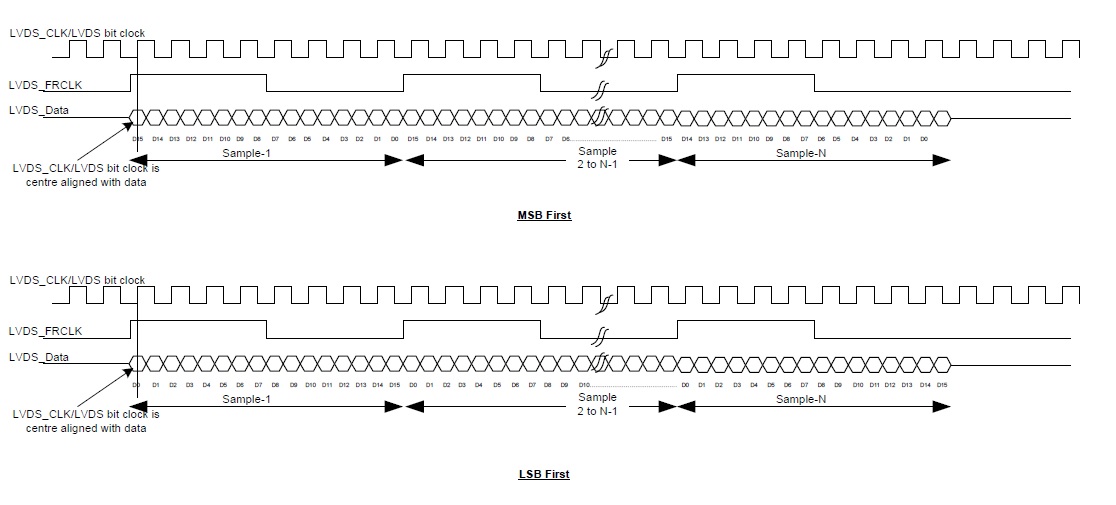

Hello, I've been contracted to build a data interface from the AWR1243BOOST development board to an FPGA board with the goal of continuously streaming data to a PC.  I've read through a lot of the available tech documents, and have a couple very basic questions, which I wasn't able to resolve.
First, it wasn't clear to me if the same data is available via the LVDS interface as is available via the CSI2 interface.  The data lanes on the chip are labelled "CSI2_TXP(M)" etc; are these also used for the LVDS outputs (and therefore, there are the same four lanes available for the LVDS IF as are available for the CSI2 IF)?  I'd like to avoid implementing the CSI2 PHY circuitry if possible.  Also, what is the function of the "HS_DEBUG" pairs?  I don't see them referenced in any doc, so maybe I haven't found the correct doc.
Second, related to this, does swru520a Technical Reference Manual (or some portion of it) apply to the AWR1243?  Its title implies it refers only to the AWR14XX and AWR16XX, though its listed under the AWR1243 family in your document navigator.  (Don't want to wade through the 2832 pages if it doesn't apply!)
My plan is to use the AWR1243BOOST plugged into the MMWAVE-DEVPACK board, then make a board to adapt the either 60-pin QSH or the 120-pin connector on the DEVPACK to an FMC, which would plug into an FPGA devboard.  Does that seem like a workable approach?
Thanks for your help.
