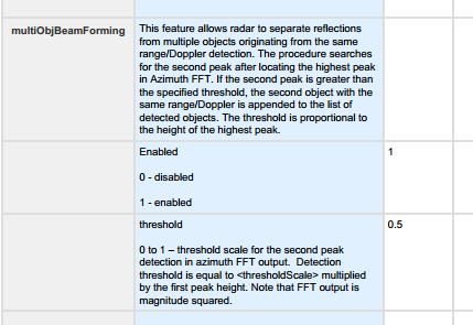

In the mmWave SDK demo, it has the configuration parameters for the multi-objects beamforming, as showing in below. However, those parameters are fixed (pre-define) in the C code, users cannot change them by changing the *.cfg file.
dataPathObj->multiObjBeamFormingCfg.enabled = MMWDEMO_AZIMUTH_TWO_PEAK_DETECTION_ENABLE;
dataPathObj->multiObjBeamFormingCfg.multiPeakThrsScal = MMWDEMO_AZIMUTH_TWO_PEAK_THRESHOLD_SCALE;
