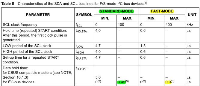

TMP75: TMP75 / Maximum data hold time at standard mode
Part Number: TMP75
I know that the maximum hold time at fast mode is specified as 900ns in DS, but now I'd like to know it at standard mode. I believe that this 900ns in TMP75 DS referred attached I2C bus specification, so I guess it should be 3.45us at standard mode though it can't guaranteed. Is my understanding correct?
