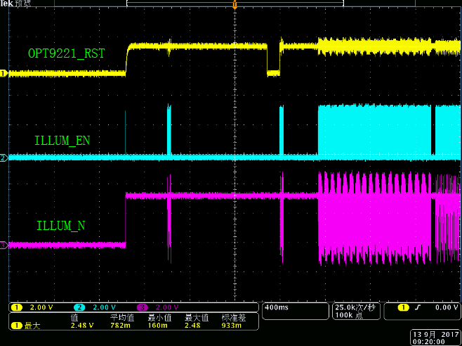

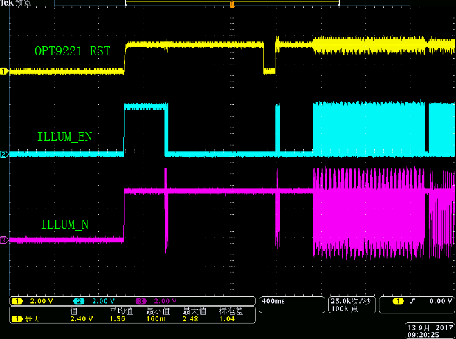

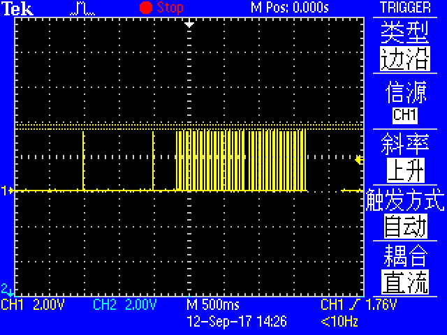

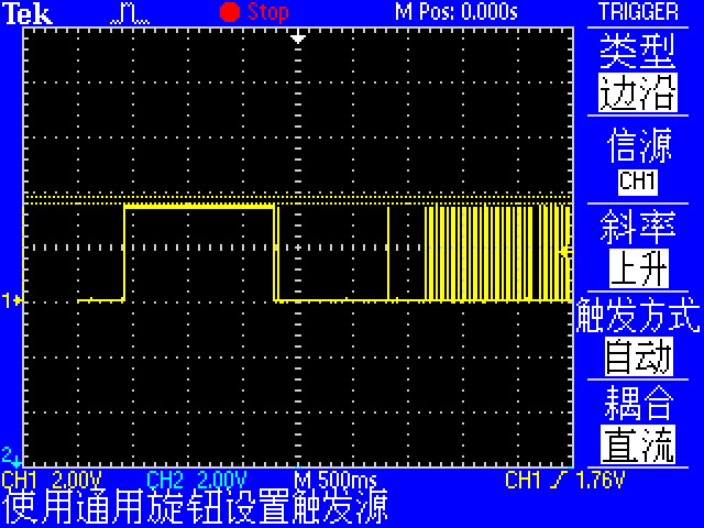

  • Hi Larry,
    You are right, the ILLUM_EN signal has been measured right at OPT8241' pin. As you can see from the two pictures below. When there happened the problem, there was a constant high level for about 400ms in the ILLUM_EN signal. The ILLUM_N has been choosen to drive the LEDs, so when there is  high level in ILLUM_EN, the ILLUM_N is also high, it will cause the lighting circuit to short circuit.
    Some of our machines will happen the abnormal situation when turn off the power and turn on the power quickly.
    Chris
    Normal
    Abnormal
  • Hi Larry,
    One more thing, there is another regular phenomenon, if the turn off time is long than about 1 minute, the abnormal situation will not happen.

  • Chris,
    is this issue resolved? I think the startup sequence does matter.
    -Larry
  • Larry,
    The issue is still in there, we have to change the power circuit.
    Chris
  • Chris,
    I'm reiterating just to clarify the situation:
    The camera boots properly when you normally power it up. However, when you stop and start the camera right after, ILLUM_EN behaves erratically.
    This seems like to be an issue with the way the power rails go down after the camera turns off. Perhaps some of the power rails are not going down to 0 by the time you restart the camera.
    Do you think you can monitor the power supplies and find out which supply is not going to 0 after turn off?
