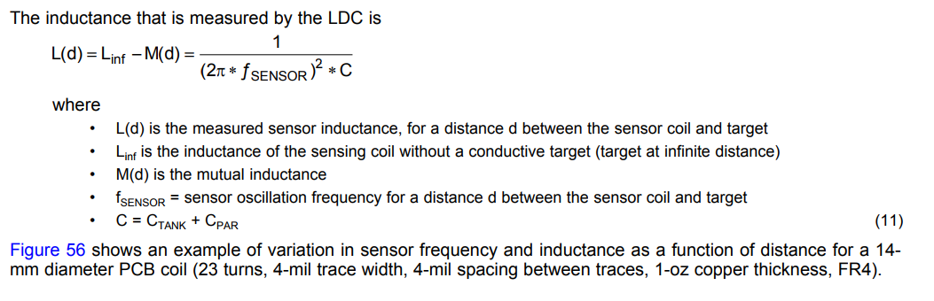

Dears,
The customer want to use FDC2214 to designing both capacitive and inductive sensors. But I don't know whether the chip can be used for induction sensing solutions? What is the main difference between LDC1614 and FDC2214? Both those two chips measure the sensor frequency, the digitized output is proportional to the ratio of fSENSOR/fREF.
