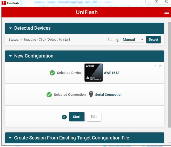

All those issues I had before were with a AR1443EVM-010 board. My TI rep said this was old and gave me an IWR1642BOOST board instead. So I'm trying again to run the demo with this new board.
Is the IWR1642BOOST not come with any firmware? The visualizer GUI just says waiting for data and won't establish connection.
I have the mmwave_sdk with the radarss demo so I'm trying to download that again.

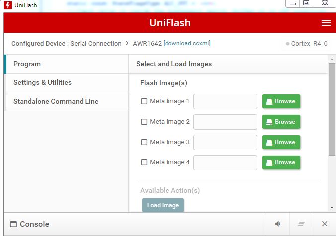

I'm still having the same Uniflash problems. I attached the images. I'm in "Manual" mode. I select the device and serial. But the firmware load still only shows me a list of meta images, there is no rss/mss option.
What firmware should I be loading? I have several bins in the SDK, the
xwr12xx_xwr14xx_radarss.bin
xwr16xx_radarss_rprc.bin
xwr16xx_mmw_demo.bin
xwr14xx_mmw_demo_mss.bin
etc.
  • Hello Ashley,
    For the IWR1642, you only need to load one image: xwr16xx_mmw_demo.bin. The should be loaded at Meta Image 1.
    This binary is found at C:\ti\mmwave_sdk_01_00_00_05\packages\ti\demo\xwr16xx\mmw.
    For the XWR16XX, the mss and bss are included on a single binary.
    Adrian
