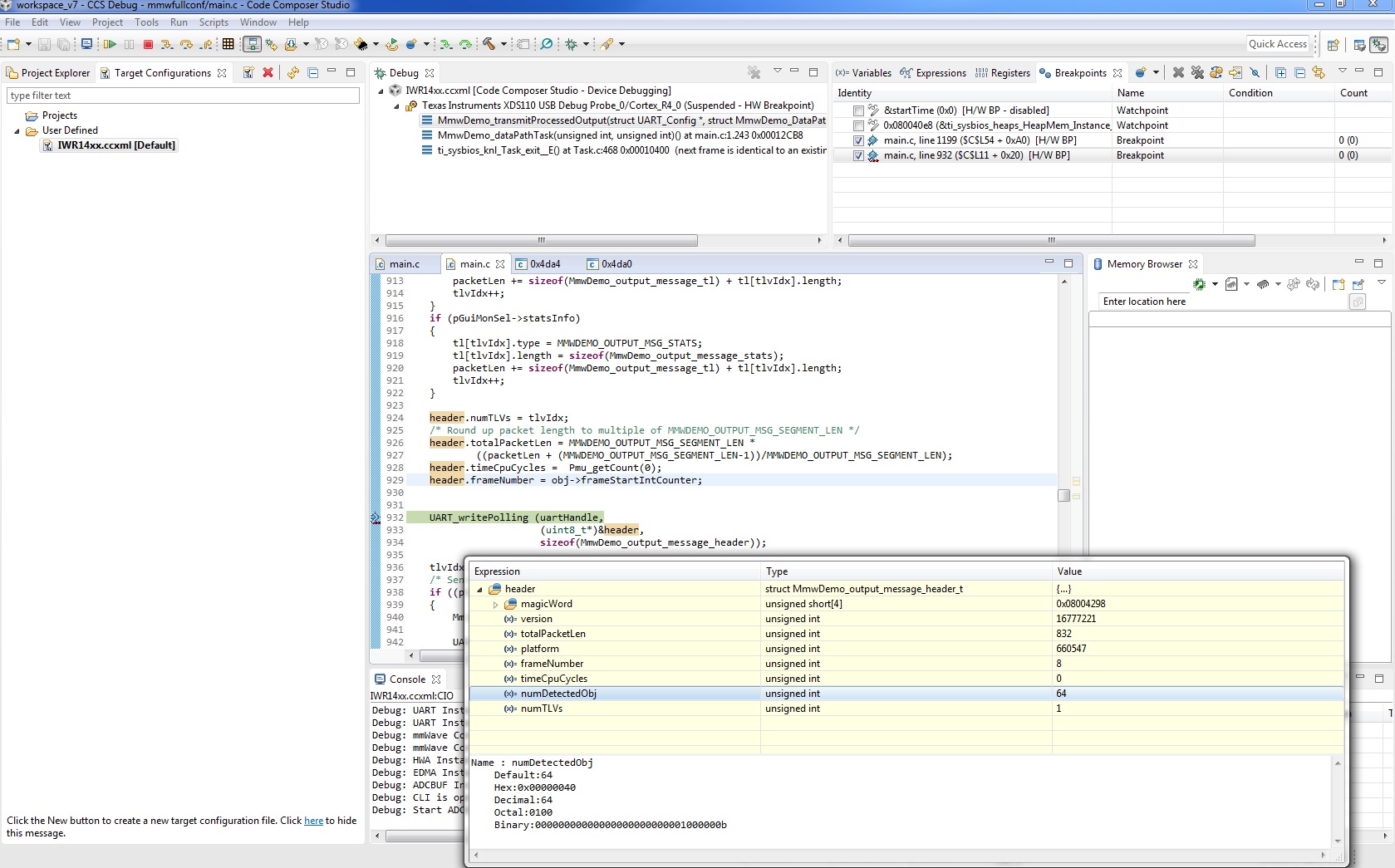

Hi everyone,
I have understood mmWave Demo Visualizer so, that ALWAYS 100 objects are captured and transferred.
BUT the variable "Number of Detected Objects" / "numDetectedObj" always shows the Number 64.
(Set a hardware-breakpoint in CCS befor transmitting the header and have a look to the variables)
Do I use a wrong formatting or is it a bug or...?
Thanks & Regards,
Johannes

  • Hi Akash,
    thanks for your answer. I can confirm that I never have seen another number here.
    In attachment you can see that I've always the same number. In my opinion this is the last change to read the value, because after row 932 the message is sent out. Nevertheless if I step through the function the value don't changes. Outside the function the value don't exist.

  • My problem is solved. I checked it with the original mmw-Project an I can see 100 objects. So the error is anywhere in my own code. Sorry.
    Best Regards, Johannes
