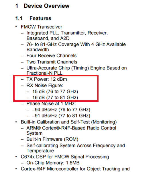

  • Hi Anil,
    Thanks for the information. Problem is, I am not aware of the nominal values for the radar equation, like TX output power, Noise figure of the receiver, RCS or SNR.
    Can you help me in finding the values for AWr12x or AWR16x??
    Another thing I want to mention is, MMwave Sensing Estimator states an 1m^2 as RCS of the adult. With TX and RX gain as 30dB and transmit power as 12dBm, It estimates that Max range for minimum detectable object as 360m and min RCS detectable at the range as 0.44m^2.
    How trust able is this information?
    What other factor will affect this estimation.
    Thanks for any help,
    Santhana Raj
  • Hi Santhana,
    The nominal values can be found from the datasheet (found here ). I've attached the relevant portions below.
    As far as the RCS of the target is considered 1msq is a good approximation. For SNR, I'd suggest plugging in 12 to 18 dB.
    Be aware that Antennas that offer gains of 24 dB or more have to be highly directional (Essentially horn antennas), meaning that if the target is not at boresight, the radar may not detect it.
