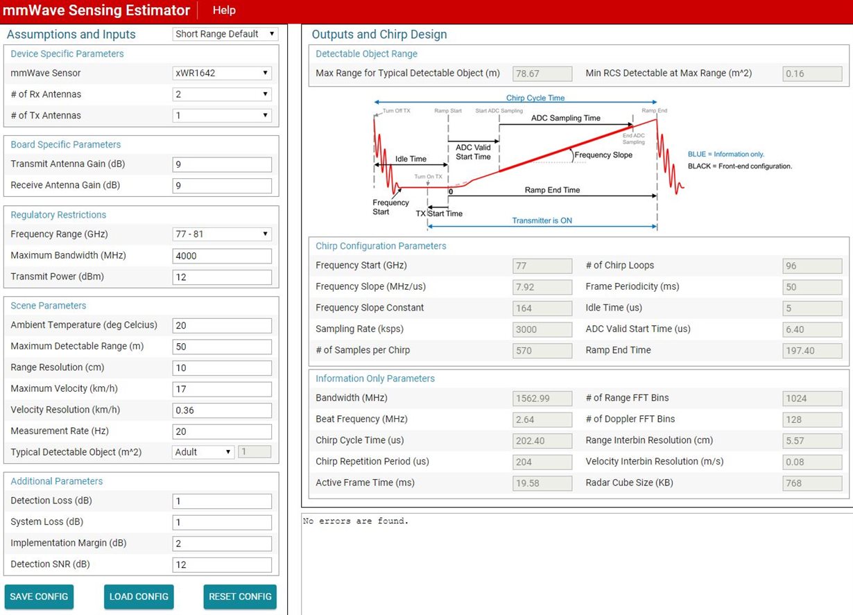

IWR1642BOOST: ERROR : mmwave sensing estimator
Part Number: IWR1642BOOST

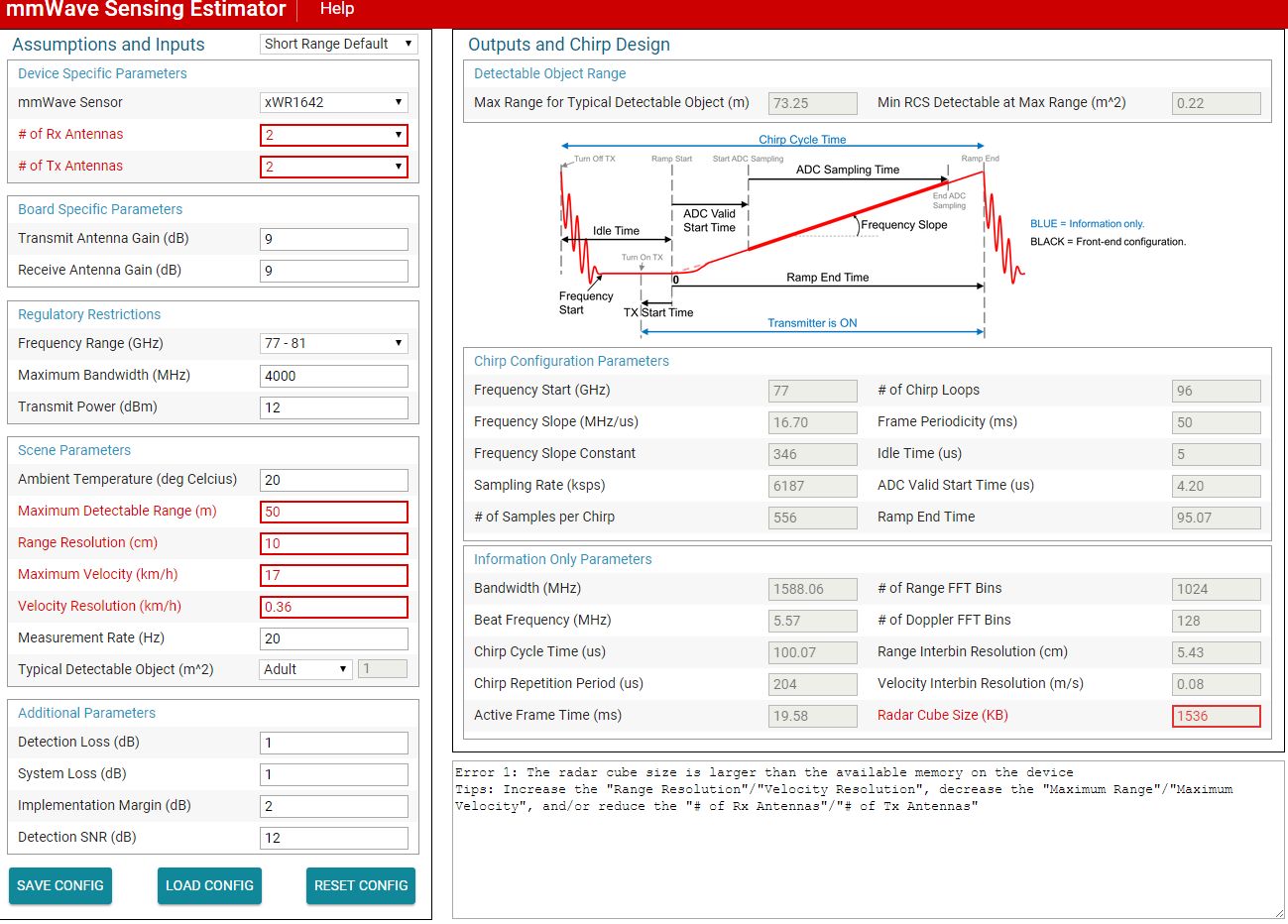

change "# of  TX Antennas"           error?
  • Zheng,
    The error is the indication that the input configurations are not right.
    The tips are also provided to change the parameters accordingly.
