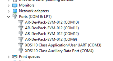

I have properly installed the device drivers for USB ports. The device manager screenshot is as below.

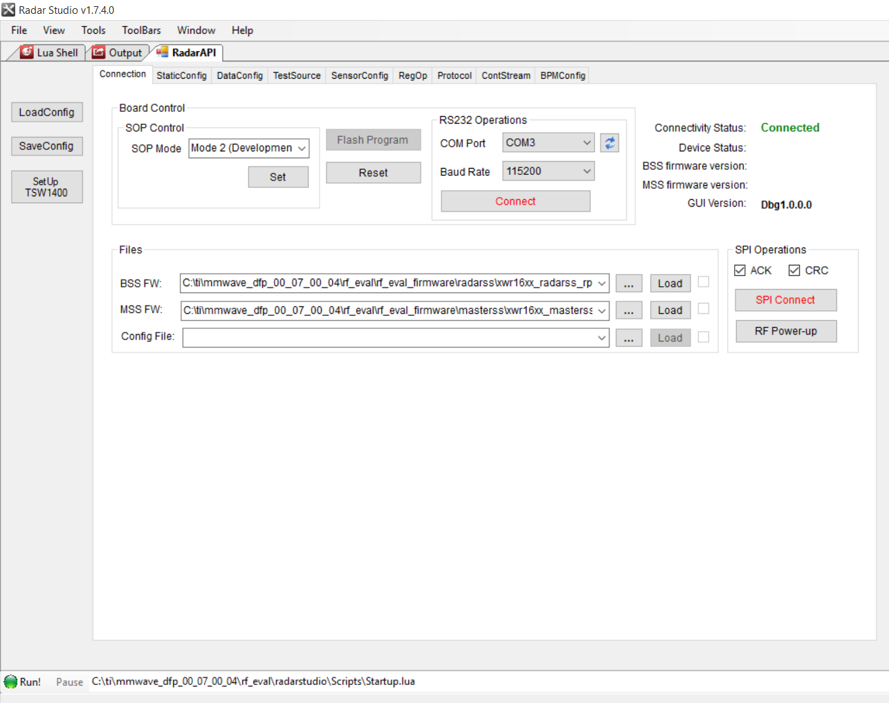

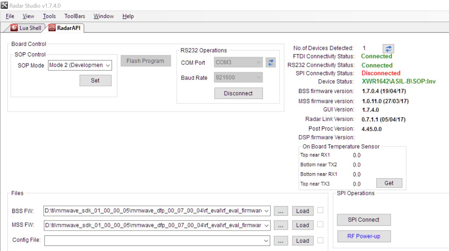

The Radar studio connection tab screenshot is as below:

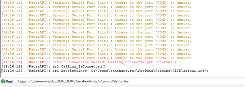

In this page, when I click on Connect button in RS232 operations, Nothing happens. There is no place where i can chk rs232 connection status as it is shown in 1.6.2.0 version of radar studio.In the output window, I get the following errors when I click connect button for RS232.
and

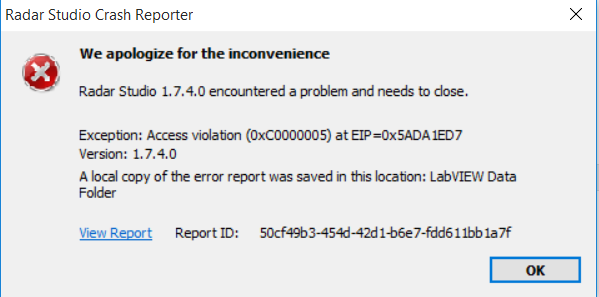

I though May be the RS232 connection is not so important and tried to do the SPI connect and load the BSS and MSS firmware. The SPI connect button changes to SPI disconnect when I click on it. But when I click on load button, the Radar studio crashes. I get the following popup for crashing.
The memory dump file and log file for this crash report is also attached.

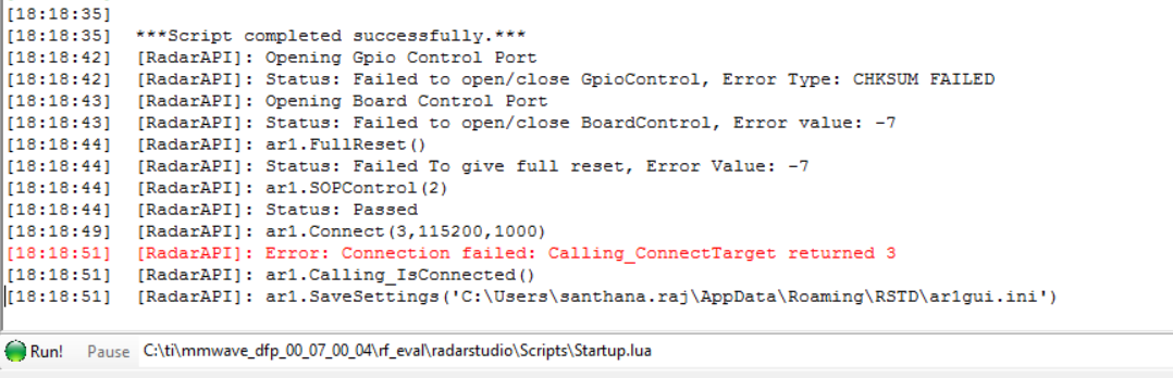

    It looks like you your SOP mode settings are not successful. I see error in the SOP mode settings .
    Did you see this problem all the time ?
    -Raghu
  • Hi Raghu,
    This is the error that I get every time.
    I would also like to add that, I erased the board flash using Uniflash and not command prompt as mentioned. And when I connect the board to TSW1400, the SOP2 jumper is removed. I hope this is okie.

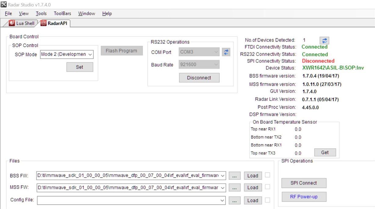

  • Santhana,
    Looking at all the RadarStudio snapshot and also your setup it is clear that you are using mix and match of the older Radar Studio with newer firmware etc.
    Below is the snapshot of the RadarStudio v1.7.4.0 in the latest MMWAVE-DFP which shows the FTDI, RS232, SPI connectivity status. Your snapshots of the RadarStudio do not show it indicating that you are not using the latest tools in the MMWAVE-DFP version "00.07.00.04".
    Please download the MMWAVE-DFP and use the latest RadarStudio in that DFP .
    Raghu
  • HI Raghu,
    Sorry for the late response. I was not able to verify your advice properly before. Hence the delay.
    I had the recent version of DFP. But again when I re-installed the package. I got an upgrade and Not this issue is resolved.
    But still I am facing some problem with SPI connectivity and configurations, WHihc I will post as a separate question/blog.
    Thank you very much for the help on this.
