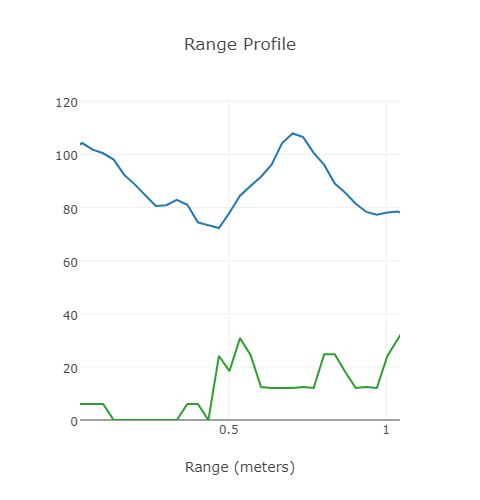

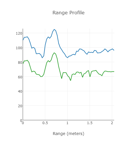

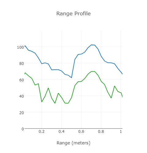

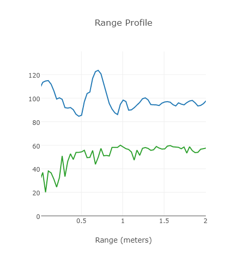

  • thank you for your answer. Today I experimented again, and it seems like the RX gain parameter (the last number on the profileCfg line) is directly related to both the profile curve and the noise curve on the range profile plot, that is, when I increase the RX gain parameter both curves shifted up, and the opposite happened when I reduced the RX gain parameter.
    Another observation is that the number of loops per frame (the 3rd number on the frameCfg line) is inversely related to the noise level. In my experiment, as I increased the number of loops per frame, the noise curve on the range profile plot shifted down, and a further increased loop counts further reduced the noise level.
    figure 1. Blue=rangeProfileCurve. Green=NoiseCurve. (Cfg info. RXgain=26. Loops/frame=10)
    Figure 2. cfg info. RXgain=26. Loops/frame=38
    Figure 3. Cfg info. RXgain=46. Loops/frame=10
    Figure 4. Cfg info. RXgain=46. Loops/frame=38

  • Hello again Zhengguo,
    1. if the more number of chirps (or loops) per frame I have the better antenna performance I can achieve (low noise).
    This is incorrect, if you want a lower noise floor you need to increase chirp duration. More chirps per frame will inherently lower your chirp duration.
    2. Should I keep the RX gain parameter as small as possible? because a larger RX gain parameter would increase both the range profile curve and the noise curve, if the range profile reflects the signal strength of the antenna, then the increase(up-shift of curves) in both signal and noise will, in fact, result in a smaller signal to noise ratio
    This is correct, Noise Floor increases proportionally with Rx Gain. To optimize this you are going to want to reduce your Rx Gain to a number that is acceptable for your application.
    Let us know if you have any more questions at this time!
