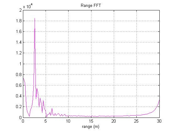

it works well, and I save memory start address at gDataCube(0x20000000) with size 32768.
Finally, I plot the range FFT
So, if I want to get more data, I have to repeat step2 and step3.
Can you tell me another ways to get more data simply and rapidly?
