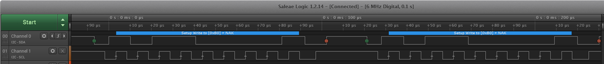

AFE4404: Receiving a NACK when trying to communicate
Part Number: AFE4404
I am using a PSoC 4200 to communicate with the AFE4404. When I try to read or write to it, I receive a NACK from the AFE4404. Below is my read and write code and the waveform that is sent over I2C when I am trying to write to registers.
Other Notes
- I have tested the code below on other sensors and it works just fine.

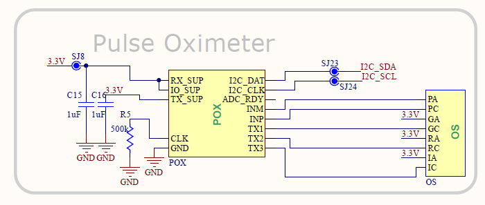

- The PCB I am using was designed by someone else and I cannot toggle the RESETZ pin
- I also cannot measure voltages from RESETZ, TX2, INM, and INP
