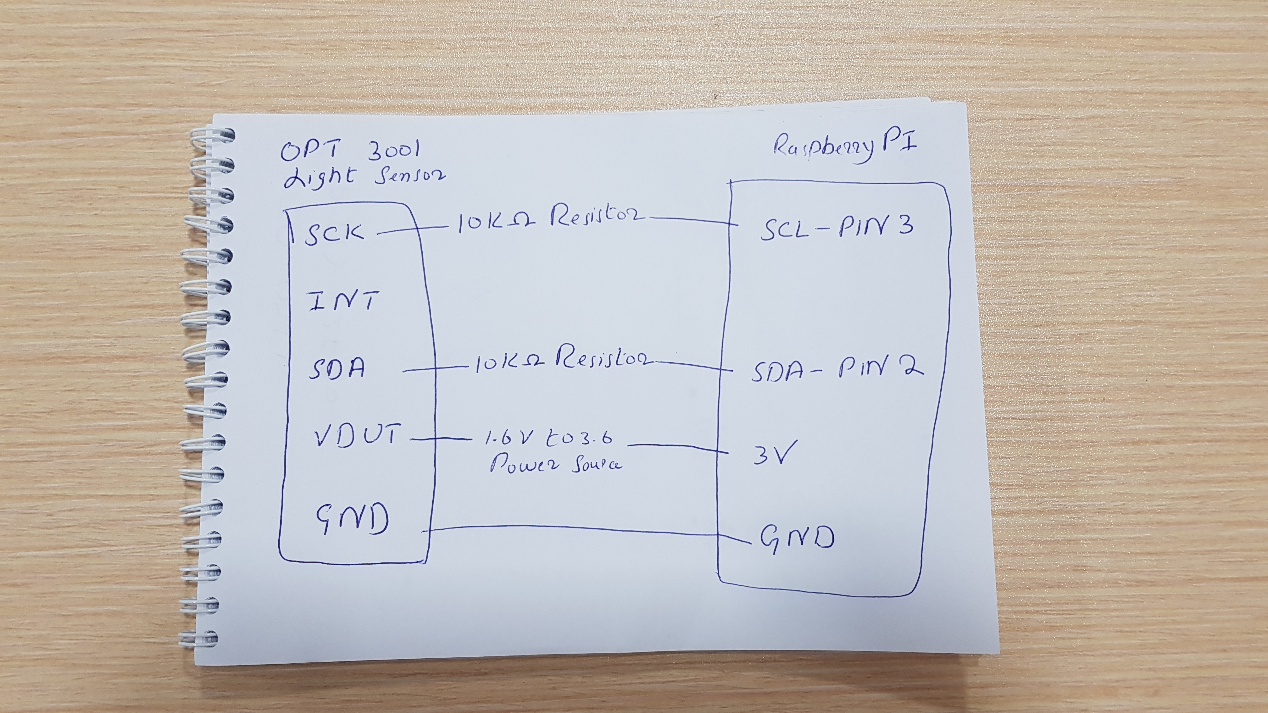

  • Dear Alex,
    Thanks for your prompt response. Please reply pn below queries
    1) Please find the attached image herewith & confirm that i2C cable specifications are correct.
    2) Please advise the commands through which we can read lux values from OPT3001.
    Akhter Ahmed
  • Hi Akhter,
    1. The 10k resistors on your diagram are pull-up resistors, correct? You may have meant this, but just to make sure, they should not be placed between the 2 devices but rather between the wire and Vdd power supply. Please see learn.sparkfun.com/.../pull-up-resistors for a nice diagram of this.
        The interrupt pin can be left floating if unused, but per the datasheet you will also need a pullup there if INT is used.
    2. For reading from the device please refer to registers 0x00 and 0x01 in the datasheet. The reading is read from register 0x00, but on power up the device will first need to be taken out of shutdown mode by writing to the config register (0x01). Please refer to the register map section of the datasheet (registers 00 and 01) for more details.

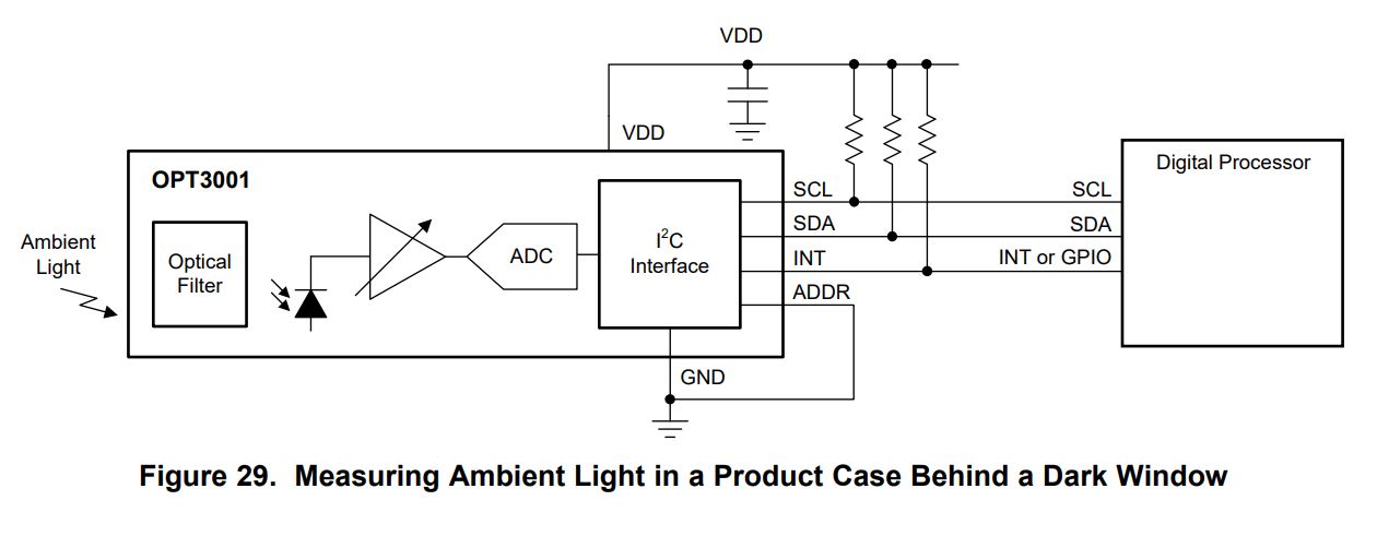

  • Dear Alex,
    Refer to above post, I am a bit confused. Please clarify on below queries.
    1) We should place pull-up resistor between OPT3001 SCK and SCL RaspberryPi? Please confirm
    2) We should place pull-up resistor between OPT3001 SDA and SDA RaspberryPi? Please confirm
    3) We should not place pull-up resistor between Vdd power supply ? Please confirm
    Its better if you share a cable configuration diagram, this will ease our task.
    Waiting for your response.

  • Hi Akhter,
    Please refer to figure 29 of the datasheet (pasted below). It provides a nice illustration of this.
    Alex

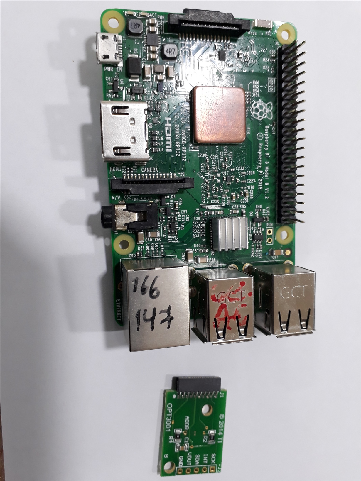

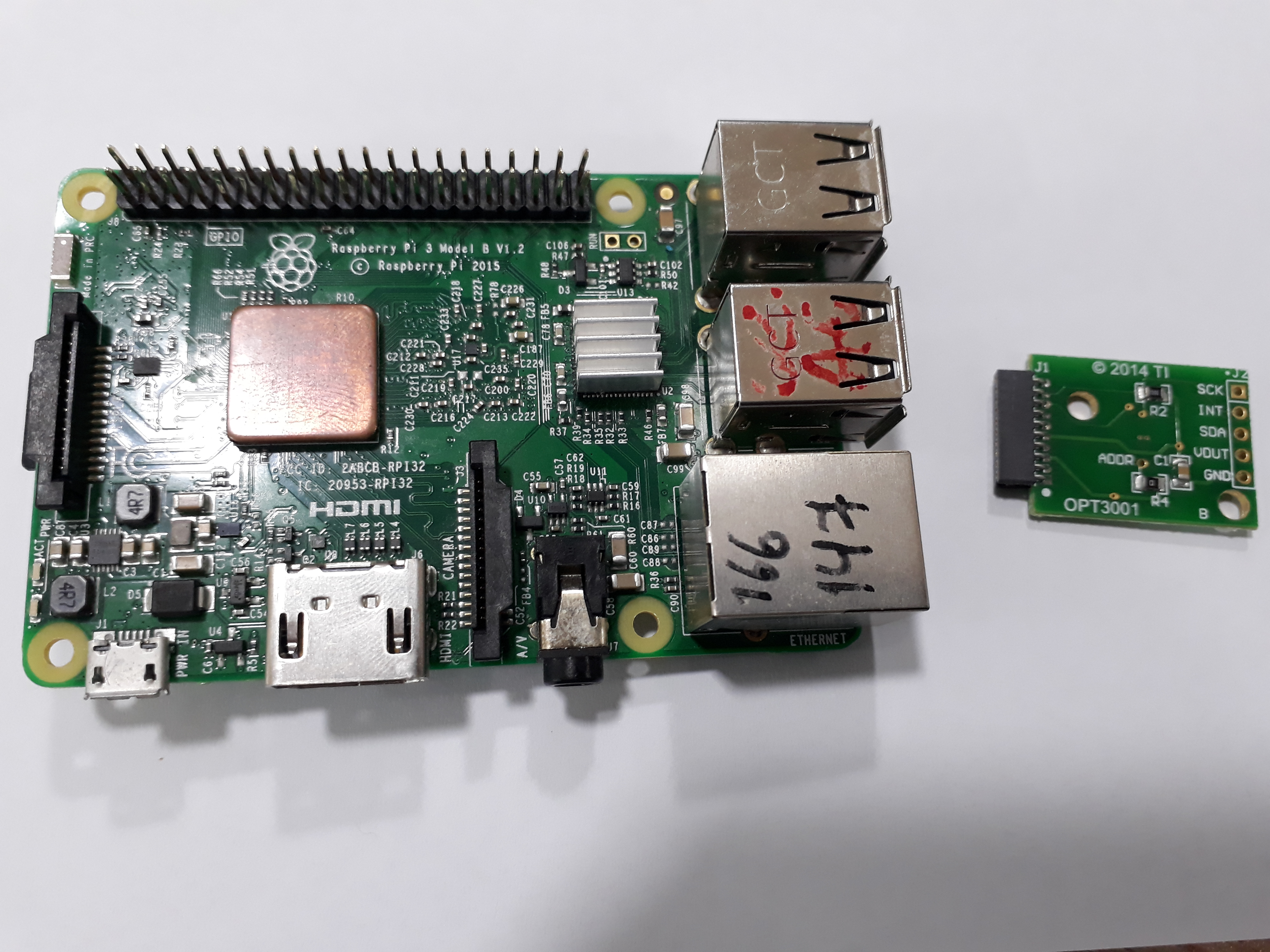

  • Dear Alex,
    We build the cable & able to deduct the OPT3001 on RaspnerryPi. OPT3001 Address is 0x44.
    When we are sending command(C8h,10h) to register 01h, it respond us (C8 10 FF FF FF FF FF FF FF FF).
    After that we start reading register 00h and it respond us (0 0 FF FF FF FF FF FF FF FF).
    Please advise what is wrong in our commands and why OPT3001 does not respond with lux values.

  • Hi Akhter,
    C810h is the default value of the config register (01h) and keeps the device in shutdown mode. You will need to bring the device out of shutdown. The lux readings can then be read from the result register (00h). Please refer to the datasheet for details on the config register. Specifically you will want to check bits 9 and 10 (Mode of conversion operation field) of the config register to choose the conversion mode you want to use.
