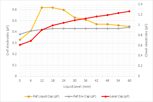

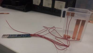

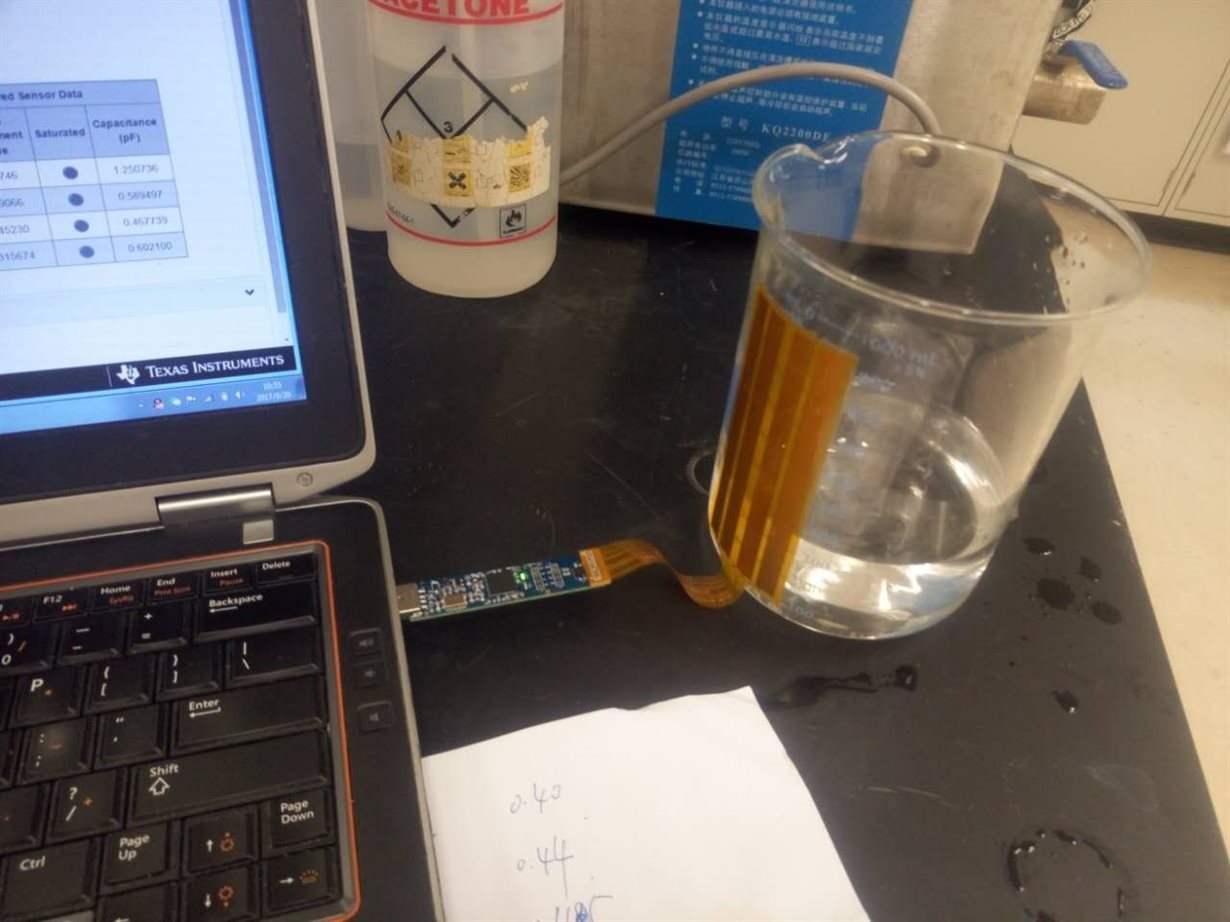

Hi Team,
My customer is modifying FDC1004EVM for liquid level sensing according to TIDA-00317 reference design. The sensitivity is as good as the application note. However, the RL shows a significant difference from the note, as you can see in the chart below and the record attached. Do you have any idea why the difference here?
Configuration of FDC1004EVM is single-end measurement:
·         MEAS1 CHA: CH1
·         MEAS1 CHB: DISABLE
·         MEAS2 CHA: CH2
·         MEAS2 CHB: DISABLE
·         MEAS3 CHA: CH3
·         MEAS3 CHB: DISABLE
