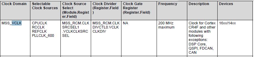

Adam,
RTICLK/WDT_CLK in the Watchdog module corresponds to the MSS_VCLK whic can be set using the RCM:CLKSRCSEL1.
Raghu
