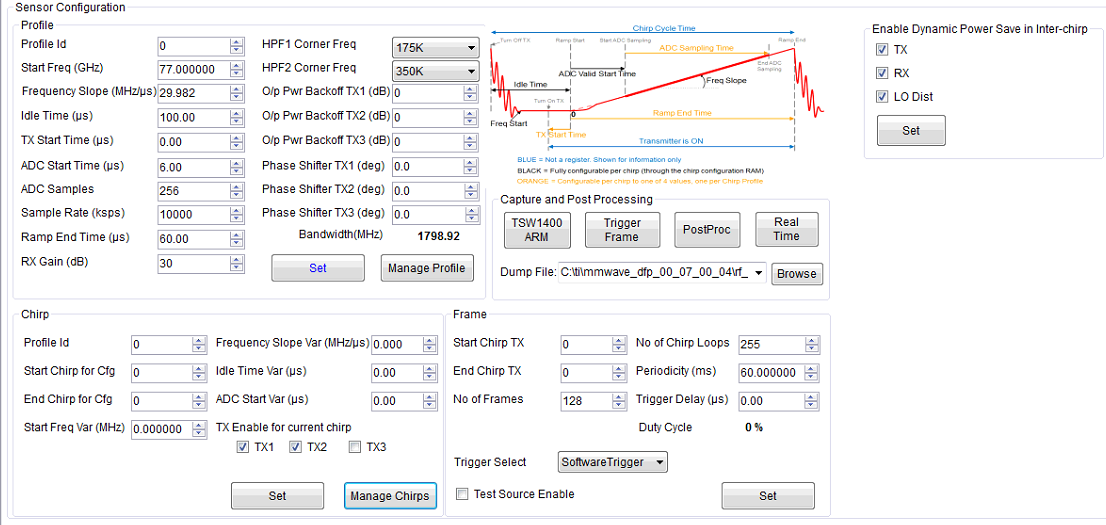

1, in the measurement of object angle and the angle resolution experiments, I use two transmit antennas、 four receiving antenna settings. The transmission signal is 128 frames, one frame includes 255 chirps,
I set up the following in the radio stduio sensor config tab, is this set  correct?
2, as above using two transmit antennas, how does it transmit the signal? Is it in the form of TDM or BPM? In the above measurement angle resolution test, what form should be used and how to set parameters?

  • 1) I set up the following in the radio stduio sensor config tab, is this set correct?
    Yes it looks like the defaults except for the frame parameters. With that high of a Sample Rate and the max Chirps, you may overflow the radar cube memory.
    2) how does it transmit the signal? Is it in the form of TDM or BPM?
    Good question. Typically it is TDM, since the chirps are processed in sequence. You only have a single chirp defined. As described in SWRA554, you will need to create a second chirp that is 180' out of phase of the first chirp for BPM. Note that if you define 2 chirps, you will need to cut the chirp loops in half.

    if I want to set 2 Tx antennas working alternately and they  emit the same  chirp signal. How should I specifically set up ‘SensorConfig’ in radar studio(Use default settings in Profile tag)?
  • If you look at the example configurations in the SDK's mmw demo, they typically define two chirps that are identical except for the Tx antenna that is enabled.  The frame config then specifies them via the StartIdx and EndIdx, and the number of Chirp loops is set to half of the total number of desired chirps.  So the frame will consist of the two chirps alternating "chirp loop" times.  In Radar Studio, click the "Manage Chirps" button to configure two chirps.  You will notice the "TXn Enable" fields. Chirp 0 would enable TX1 only, and chirp 1 would enable TX2 only (if you've enabled TX1 and TX2 on the parent screen).

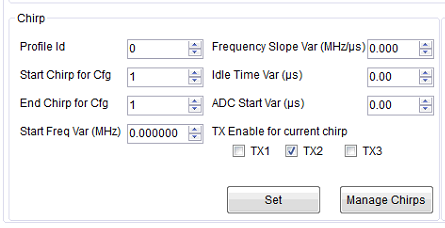

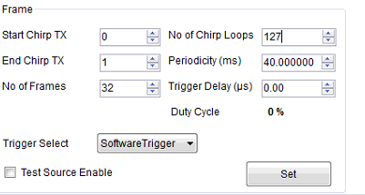

    in radar studio,If I want to set 2 Tx working alternately, and radar transmits signal with 32frames and 256 chirps in one frame.
    I need to set 'Start Chirp for Cfg'=0, 'End Chirp for Cfg'=0, and TX Enable for current chirp = TX1; then, 'Start Chirp for Cfg'=1, 'End Chirp for Cfg'=1, and TX Enable for current chirp = TX2. Then in Frame tag, I need to set 'Start Chirp TX'=0 and 'End Chirp TX'=1, which means in one frame, chirp with TX1 and chirp with TX2 work alternately.

  • I'm not quite sure what you are showing. I believe you need to click on Manage Chirps and fill in the first two entries, then in the "Frame" box, use Start Chirp Tx=0, End Chirp Tx=1, No of Chirp Loops 128.
