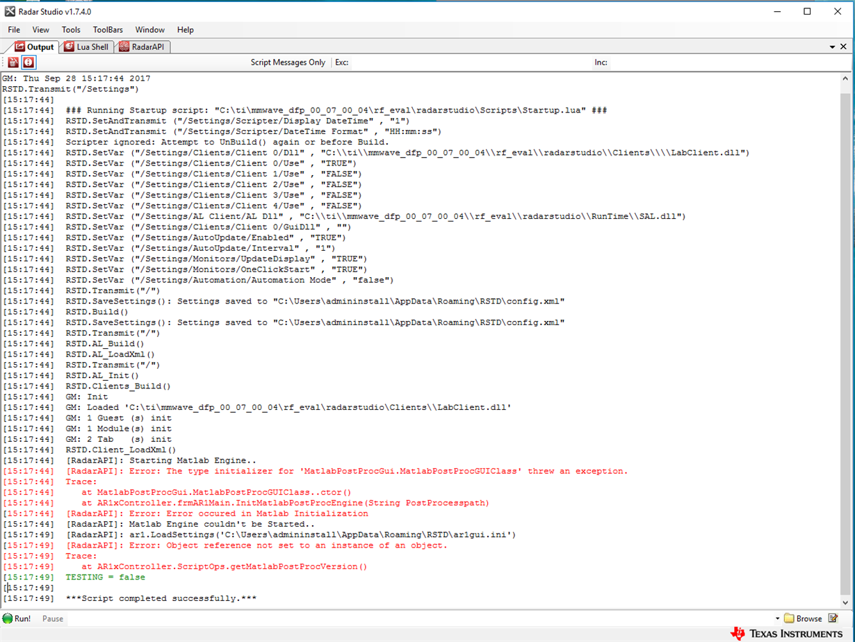

AWR1642BOOST: Radar Studio "Matlab Engine couldn't be Started"
Part Number: AWR1642BOOST
Hi, i've had no luck in getting the Matlab Engine to run by Radar Studio(Screen Shot attached as pic, error message copy pasted below
[15:20:45] [RadarAPI]: Starting Matlab Engine..
[15:20:45] [RadarAPI]: Error: The type initializer for 'MatlabPostProcGui.MatlabPostProcGUIClass' threw an exception.
[15:20:45] Trace:
[15:20:45] at MatlabPostProcGui.MatlabPostProcGUIClass..ctor()
[15:20:45] at AR1xController.frmAR1Main.InitMatlabPostProcEngine(String PostProcesspath)
[15:20:45] [RadarAPI]: Error: Error occured in Matlab Initialization
[15:20:45] [RadarAPI]: Matlab Engine couldn't be Started..
[15:20:50] [RadarAPI]: ar1.LoadSettings('C:\Users\admininstall\AppData\Roaming\RSTD\ar1gui.ini')
[15:20:50] [RadarAPI]: Error: Object reference not set to an instance of an object.
[15:20:50] Trace:
[15:20:50] at AR1xController.ScriptOps.getMatlabPostProcVersion()
[15:20:50] TESTING = false
[15:20:50]
[15:20:50] ***Script completed successfully.***
Here's my hardware configuration:
I have AWR1642BOOST, MMWAVE-DEVPACK, and TSW1400EVM connected together. BOOST and EVM powered by 5V external supply, all 3 boards connected by USB (detected ports/devices in device manager/Windows 10-FTDI driver successfully installed after disabling driver signature check in windows 10)
Here's my software configuration
(and yes i have followed the steps of copying manually some files from Radar Studio into HSDC Software folders as instructed in Radar Studio manual).
#1 I have installed Matlab Runtime 8.5.1
#2 I have updated the XDS driver with "ti_emupack_setup_7.0.48.0_win_32"
#3 Radar Studio version is v1.7.4.0, installed as part of dfp AFTER matlab engine and FTDI as prescribed
#4 HSDC Pro is v4.7
Yes basically Radar Studio can;'t load Matlab runtime. I even uninstalled my Matlab 2016a for just in case, still doesn't work!
Any pointers? Thanks you very much guys
