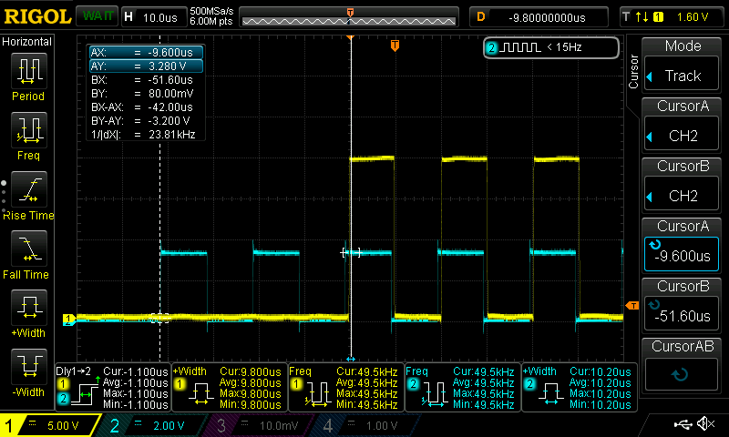

    If you are using the bi-static half-bridge configuration, then you must keep R35 populated with a zero ohm short. Do not populate the R34 zero ohm short. In the half-bridge configuration, one terminal (the negative terminal for polar transducers) of the transmitting element must always be grounded. This may explain why you are unable to see any return echoes.
    If this does not resolve your error, can you also use an oscilloscope to probe the positive terminal of the transmitting transducer to monitor the excitation voltage and waveform? You can also try adding a larger external voltage supply (up to 28V).
    Your last post did not contain an image (must have failed to attach), but no need now - let's see if the R35 short fixes your problem.
  • Hi Akeem,
    Well, to keep the EVM as complete as possible, I didn't remove the Murata SMD transducer. I disconnected it by removing R35, and connected one end of the transducer to J9 pin 2, and the other one directly to GND.
    The maximal Vpp is not provided for this transducer. Do you think 28Vpp is still safe ? Any comment on the transducer choice ? This is a disk transducer.
    I checked the positive terminal with an oscilloscope, and I see the square wave followed by the transducer decay ringing.

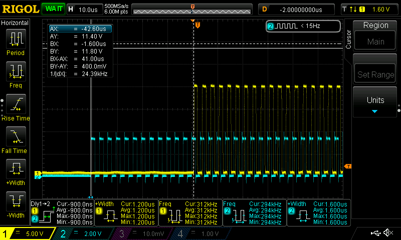

  • Sam,
    I now understand your intended modification. To drive an external transducer in bi-static mode, but keep the MA40H1S-R populated, ensure you've applied the following modifications from the daughtercard's default state:
    1) Desolder R35 to float the MA40H1S-R negative terminal
    2) Desolder R33 (optional but recommended) to prevent unintended loading of the XDCR. 2.0kOhm may or may not be suitable for the Steminc SMD10T2R111WL. You can start with a large value (10kOhm) if preferred.
    3) Desolder R32 to prevent the transmit only signal from appearing at INP as a return signal
    4) Connect the transmitting transducer's pos-terminal to J9-1, and the neg-terminal directly to ground.
    5) Connect the receiving transducer to J11.
    If these modifications match your setup, then your hardware should be ok. If you see a square wave followed by the decay-ring, then excitation should be successful. Is the driving square wave's frequency at 214.8kHz? Also, I recommend that you disable the current limit to prevent unintended damage to the driving FETs. Most transducer don't require more than 50mA, so you can set the enable the driver current limit to the lowest setting. I need to update our documentation to reflect this new direct-drive recommendation.
    In my experience, the high-freq transducers typically require large driving voltages, which is why we typically recommend pairing with a high-freq transformer(as previously listed). 28Vpp at direct-drive should be safe, but you could incrementally check performance up to 28V to see if there is any difference as you increase the voltage.
    I would recommend that the Write Coefficients button click be the last change you make before issuing a burst+listen command to prevent an unintended rewrite of the coefficients when changing any other setting.

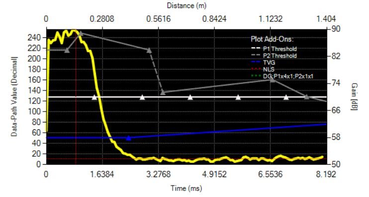

    As In continued my investigations today, I've noticed that the resonance frequency of this transducer is 245 kHz (and not 215). The ringing frequency after some time ends at this frequency.
    I've also noticed that in bistatic configuration with the RX transducer unconnected and no damping resistor on the TX transducer, a strong signal couples to the input of the PGA460, which is dramatically reduced when the RX pin is grounded or with a damping resistor. I put 470R and it seems better.
    Now, it also seems that the RX transducer must be damped in some way, otherwise there's a large blind zone. Adding 180k in parallel gives the following result with 2 transducers 2cm apart.
    Now , it looks like that shape doesn't change when I move the sensors. It looks more like this is EM coupling or so. Have you had experiences on your side ?

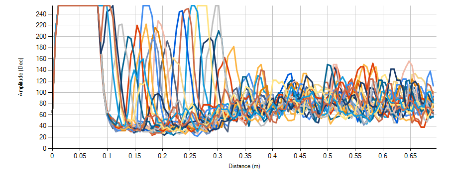

    I tried today with the Murata MA300D1-1, and the results are much better. The ringing seems to stop at about 15cm distance with 5k6 damping resistor.
    Do you have experience with that sensor ? If yes, what are your settings, in term of damping resistor, digital gain, TVG/AFE gain ?
    I still have a very strong noise (unfortunately I have no picture right now to attach).
    If you have no settings for this very transducer, could you share some of a similar configuration ?
    I'm using a mono-static configuration, with the EVK board in half-bridge mode, where I disconnected the SMD transducer as described above, using 20V.
    Thank you in advance for your feedback.
    Sam
  • Hi Sam,
    An important update about the PGA460 EVM GUI: Version 1.0.0.9 (available now) no longer requires you to re-check the Burst Frequency Range Shift and re-write the coefficients after changing any of the device settings. Prior to sending a burst-and/or-listen command, the GUI now checks to see if the Burst Freq Range Shift is checked. If so, it will automatically ensure the equivalent bit is logic-high in the TVGAIN6 register, and that the BPF coefficients are updated with the values shown in the BPF coefficient calculator tool. (No more having to manually setup and correct the GUI for high-freq eval!)
    I have evaluated the Murata MA300D1-1 in a mono-static half-bridge driver mode with a 20V supply and a R_Damp value of 24.0kOhm. The results are as follows:

    Echo Data Dump (from 30cm down to 10cm):
    (short range can be improved by decreasing digital gain multiplier value)

    I'm currently investigating the DRV8870 based full bridge that is in the reference designs, and it looks like it has a strange behavior. When I compare the signal on an input pin, it has a ~40us blind time during which the driver won't turn any pin high. You can see it from the pictures below : the blue trace is the driver's input, the yellow trace is the output.
    I've tested it at both low and high frequency, the time is the same, resulting in about 2 lost pulses at low frequency and 15 at high frequency.
    Did you experience similar behaviors ?
    Sam
  • Hi Sam,
    The 40us delay is due to the DRV8870 waking-up from sleep mode.
    As described in the DRV8870 datasheet:
    7.3.2 Sleep Mode
    When the IN1 and IN2 pins are both low for time t_SLEEP (typically 1 ms), the DRV8870 device enters a low-power
    sleep mode, where the outputs remain High-Z and the device uses I_VMSLEEP (μA) of current. If the device is
    powered up while both inputs are low, it immediately enters sleep mode. After the IN1 or IN2 pins are high for at
    least 5 μs, the device is operational 40~50 μs (t_ON) later.
    Since this mode cannot be avoided on the PGA460-DRV8870 full-bridge reference design as-is, you will need to transmit more pulses to account for the lack of excitation during the DRV8870's t_ON delay window. The supporting PGA460 Full-Bridge Driver app note will contain a comment about this DRV8870 limitation. Fortunately, most transducers' sound pressure levels (SPL) for maximum ranging become saturated by 20 pulses. Thus, margin is available for n-blank pulses given the PGA460 supports up to 31 pulses max.

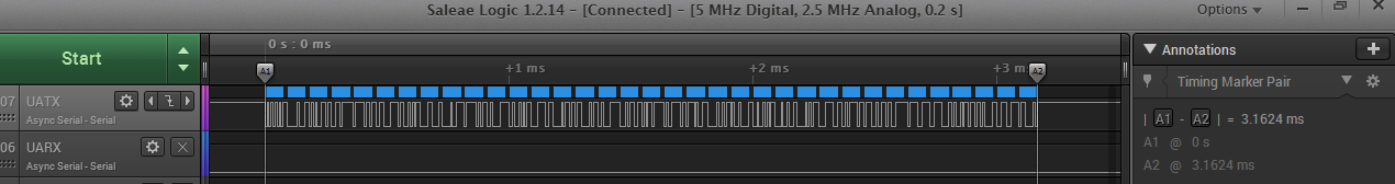

    I have another question : in my design, I need to use the PGA460 very rapidly after it was powered up. Volatile registers must be reprogrammed before the unit can be used.
    When programming the thresholds, the GUI writes to the register about every 200ms. Is it possible to program all volatile registers in a much shorter period of time ? At 115200 bps, programming one register takes about 500us, which means about 25ms.
    Thanks and best regards,
    Sam
  • Hi Sam,
    The GUI introduces excessive delays and timing overhead due to the USB-to-PC communication. I would not refer to the GUI as an example for timing requirements.
    To write to all thresholds as quickly as possible, I recommend that you use the bulk threshold write command (CMD16). At 115.2kBaud, the write time is calculated as 3.34ms.
    Here is my ideal calculation of the timing requirement for CMD16:
    Timing budget per sensor    Unit
    Sync 1 bytes
    Addr+Cmd 1 bytes
    Checksum 1 bytes
    CMD16 Thr Bulk (Write) 32 bytes
    TOTAL BYTES 35 bytes
    TOTAL UART Bits (w/ 1Start, 2Stop) 385 bits
    Baud Rate 115200  baud
    TOTAL UART Time (at Baud Rate) 0.003342014 s
      299.2207792 Hz
    When timing this command using a logic analyzer, and executing CMD16 using the PGA460 GUI's Interface Mode --> UART -- > Command (Single Addr) --> CMD16 --> Run Command button, I measured ~3.16ms:
