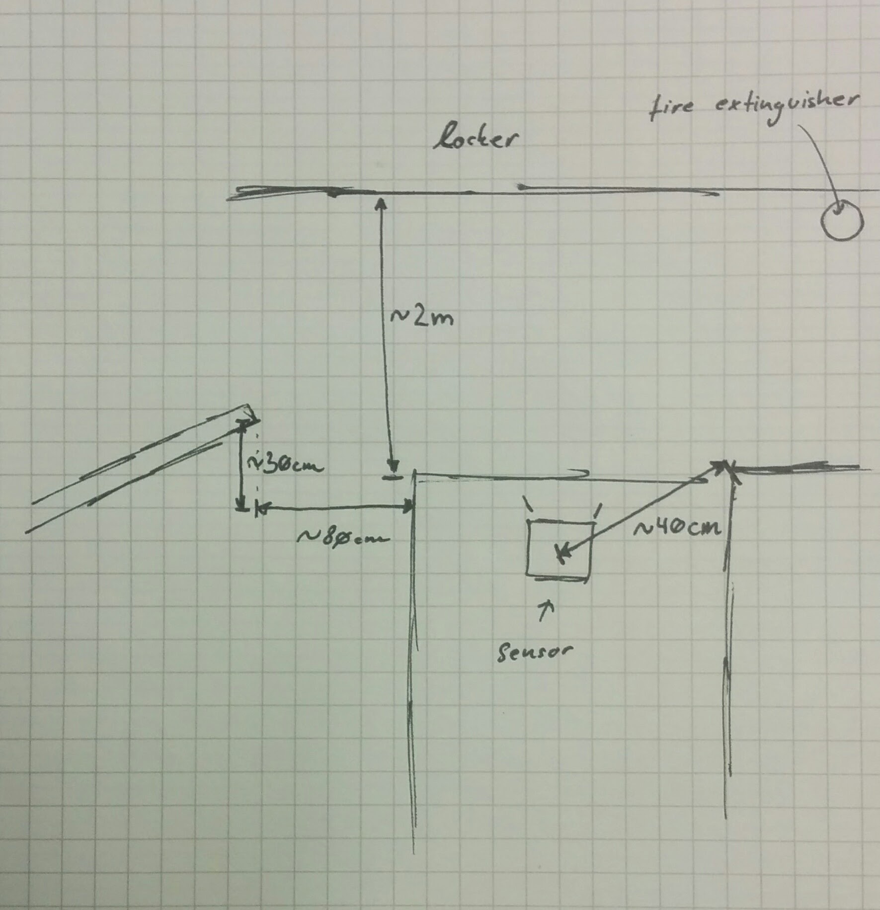

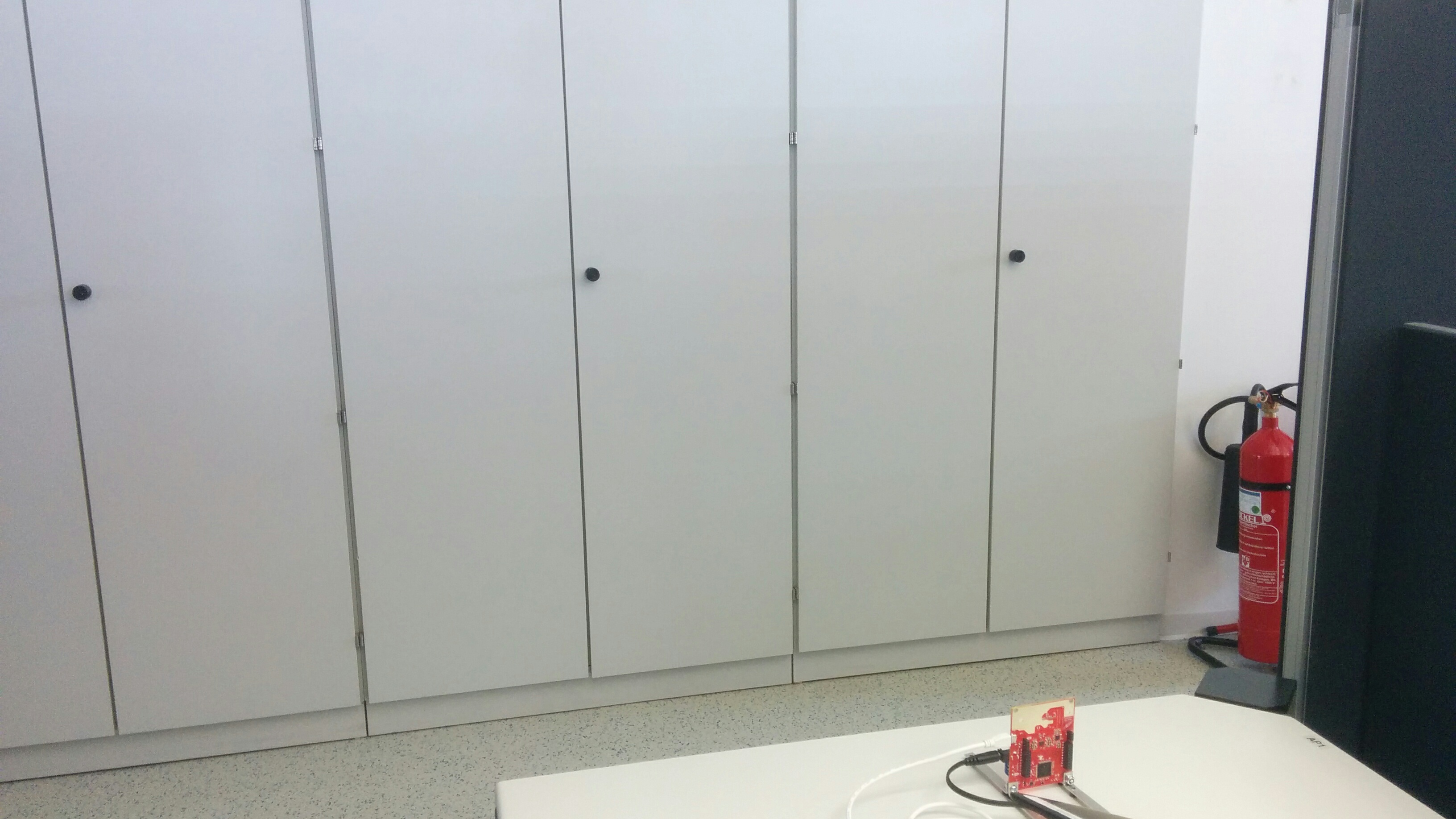

  • Hi Akash,
    please excuse my late response. Sadly, I did not have time to do some tests on the ADC sample rate, yet.
    I agree with what you wrote about moving objects. But since the interferences do also occur while there's no moving object in the sensor's field of view and as I said the source code for processing range and noise profile data is the very same, I still wonder how/why those are caused! Any calculations in my source code are -- apart from that it is Python instead of JavaScript, entailing different syntax and called functions -- exactly as in the DemoVisualizer's mmWave.js file.
    Not sure if this assumption is correct, but isn't the occurrence of the interferences even without moving objects indicating, that it's not an ADC sample rate related problem?
    See a picture and a drawing with distances of the scene below.
    Thanks!
