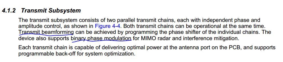

  • And also, based on the below screen short from AWR16/14 technical reference manual, it shows that the AWR chip can perform transmit beamforming and BPM. However, no other place of mentioning how to implement them.
  • Hello Xining,
    PhaseShifter is only applicable for AWR1243 and not xwr1642. For xwr1642, one need to use the BPM. Please refer to API documentation in
    ti\control\mmwavelink\docs\html folder for more details.
    You can refer to below APIs for BPM configuration:
