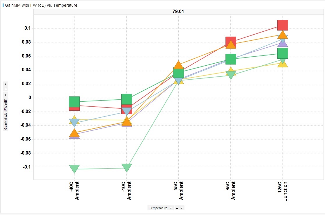

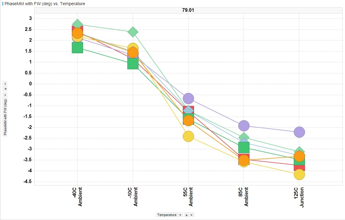

Hi all,
we are studying the AWR1243 chips to verify the feasibility of a synthetic array with AWR1243 in cascading configuration.
In our analysis we are interested for the long time chip stability… then, has anyone taken acquisitions for long period (more than 10 seconds, which is the limit of Radar Studio + HSDC + TWS1400) and tested the Phase Stability and Amplitude Stability on Rx and Tx?
For example tests in controlled environmental conditions and with a reference target (such as a corner reflector) at a fixed distance.
 In other words, do you have any characterization of phase and amplitude variations vs thermal and/or vs time for long-period analysis?
