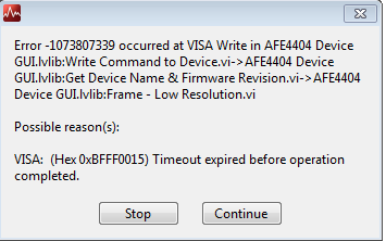

    One more item that might be important.  After clicking on "OK" in the FW update error message, there is an additional error that occurs:
    I appreciate any guidance on how resolve this.  If someone at TI could look at the AFE4404 EVM GUI source code and determine the conditional statement that leads to this error message, perhaps this would provide a clue?
    Steve

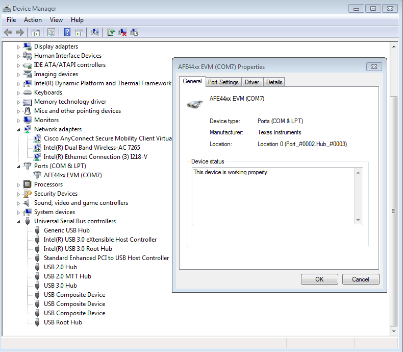

  • Hi Steve,
    After the firmware update, does the EVM gets detected properly in the device manager?
    Can you please share the screenshot of the device manager ( showing "Ports (COM and LPT)")?
    Prabin

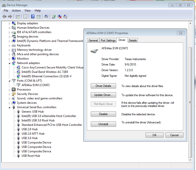

  • Hello Prabin,
    After the FW update, the EVM seems to be detected properly by the device manager.  Please see the Ports (COM & LPT) properties showing the devices is installed correctly and also the driver version.
    Steve
    I
  • Hi Steve,
    Looking at the attached image , I can see that the EVM is detected properly.
    Now if you want to know the version of the EVM you can use serial programs (such as Docklight, Putty) by following the steps given below.
    1) Connect the EVM and open the corresponding Port in the serial program with baud rate of 230400.
    2) Transmit 0x04 and 0x0D to the EVM
    3) EVM should reply the version number ( for AFE4404 it should say 0x04 0x02 0x34 0x34 0x30 0x34 0x03 0x0D)
    Prabin
