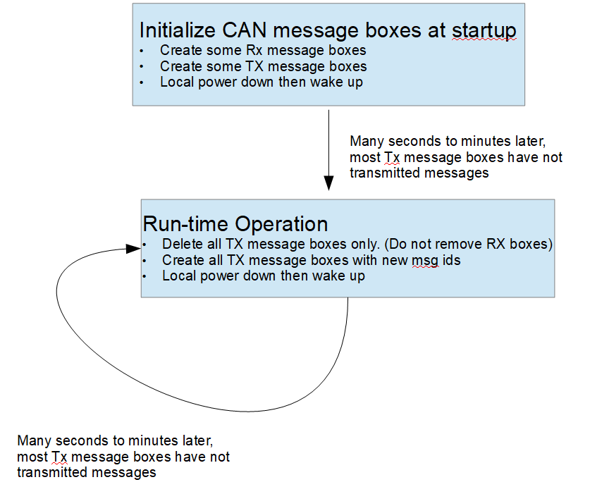

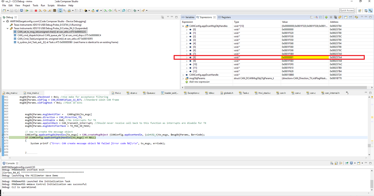

  • Raghu;
    I have added the relevant code to our application and we are still seeing issues.
    We create a number of message box objects at the start, all with the default message IDs. Then we change the message IDs of the TX message boxes at various points during run time. So there are N message boxes, and T number of TX message boxes and R number of RX message boxes, where T + R = N.
    The way I have implemented your suggestion is as such:
    1) Delete 1 or more message box objects
    2) Create 1 or more new message box objects with the new message IDs
    3) CAN_setOptions() to power down
    4) CAN_setOptions() to wake up
    ... some time later
    5) Transmit with the new message ID
    This works the first time. I am able to change 1 or more of the TX message IDs and then transmit with the new message ID.
    When the time comes to change the message ID a second time, the system hangs.
    Using the debugger, the issue appears to be within the CAN_setOptions() during the power down segment. The system appears to be stuck in the do-while waiting for the system to fully power down.
    Occasionally we will also see this error during run time, which appears during step 2 above (creating new message objects):

  • Raghu,
    I'm a colleague of Joe Shidle and am attempting to resolve this issue.
    To cover our issue again, here is what we are attempting to do based on our use case and your suggestions. The key point here is that we need to change our CAN message IDs at random intervals during run-time:
    We can perform the "Run-time Operation", without problems, two times. Upon the third time attempting to delete, create, and perform the power down operation, the first CAN_MsgObjHandle created with CAN_createMsgObject() ends up pointing to a seemingly invalid memory address. This will then throw an exception and halt the system. Please see the debug window below:
    The exception thrown is seen here:
    Exception occurred in ThreadType_Hwi.
    Hwi handle: 0x0.
    Hwi stack base: 0x8026100.
    Hwi stack size: 0x1000.
    R0 = 0x08f81e08 R8 = 0x0001f3b0
    R1 = 0x00000001 R9 = 0x00000000
    R2 = 0x08015cf4 R10 = 0x00000001
    R3 = 0x08025d50 R11 = 0x00000000
    R4 = 0x08015cc8 R12 = 0xdffc0000
    R5 = 0xfffffdec SP(R13) = 0x080270a0
    R6 = 0x0001f5ea LR(R14) = 0x00006edc
    R7 = 0x00000002 PC(R15) = 0xdffc0000
    PSR = 0x600c019f
    DFSR = 0x00000000 IFSR = 0x0000000d
    DFAR = 0x00000000 IFAR = 0xdffc0000
    ti.sysbios.family.arm.exc.Exception: line 201: E_prefetchAbort: pc = 0xdffc0000, lr = 0x00006edc.
    xdc.runtime.Error.raise: terminating execution
    With the exception of transmitting a message for every message box, we are following the suggested sequence of steps listed here:

    I have modified the "dcanTransmitTest()" as per  your  writeup.I have written the code for about 22 messages as a sample.
    Please look at my application code and let me know if it suits your requirement or alternately you can send upload the changes you have done in your DCAN transmit code so that I can reproduce the issue here on my setup.
    With reference to your requirement, how many different message identifiers do you have to transmit during the runtime?
    Raghu
  • Raghu,
    Thanks for your help. First, there was an issue on our side due to the way we were storing received CAN messages. This was causing memory corruption, hence the garbage returned when creating CAN message objects.
    Second, as the code in your 2604.main.c shows, the order of delete, set, then create was critical.
    I can't say exactly how many message IDs are required during runtime, but the critical requirement was that we can change them at runtime an unrestricted number of times.
    Erik
  • Hello Erik,
    Thanks for your update.
    If the issue is resolved , please mark the response that resolved the issue and close the post.
    Raghu
