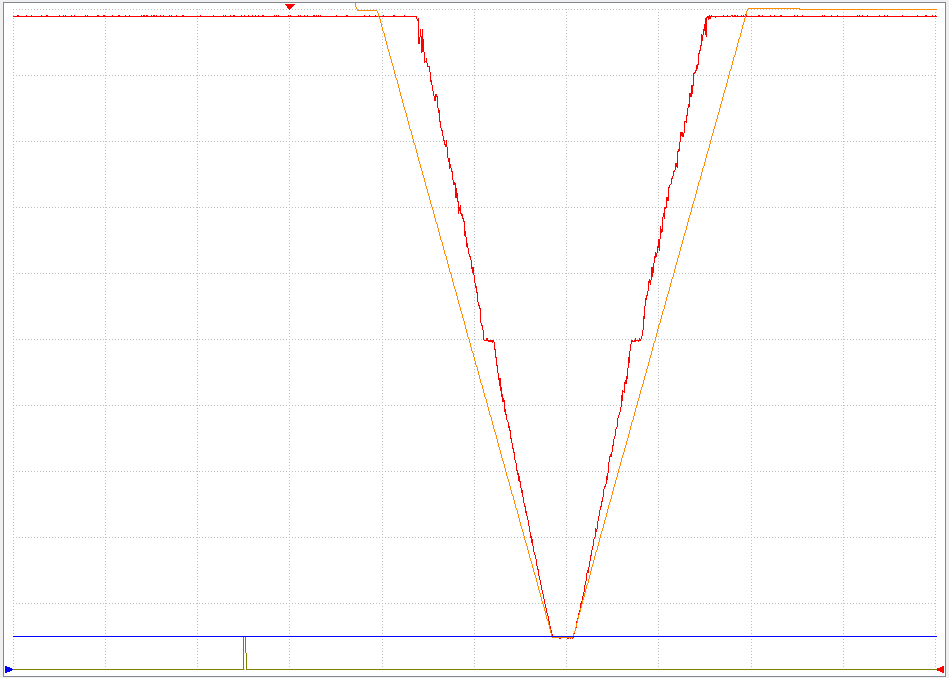

  • This might be a good clue for the flat sections. Attached is a graphic showing a linearized output of the FDC data that is run through a DAC (red line). The orange line represents the sensor gap (1mm/div).
    Eventually I was able to monitor the RAW FDC output and found that the number it was getting stuck at was 35791394 which turns out to be 0x2222222. There must be some significance there. At first I was wanting to blame my code, but on further inspection I believe this is real data coming from the FDC.
  • Hello Gerry,
    My apologies for the delay in response. What you are seeing is probably due to Injection locking; refer to section 2.5.2 of www.ti.com.cn/.../snoa944.pdf. The FDC221x can also experience this effect. Try increasing the sensor IDRIVE, improving the sensor Q, or shifting the sensor frequency to avoid the region.
    The internal oscillator is much less likely to cause this effect. If you cannot use the internal oscillator, try to reduce the voltage drive of the external oscillator signal; also try to avoid routing the oscillator too close to the sensor signals.
    ChrisO
  • Thanks for the reply Chris. I'll see if I can adjust my frequencies to avoid the injection locking but with the amount of temperature drift causes the sensor frequency to vary quite a wide range.

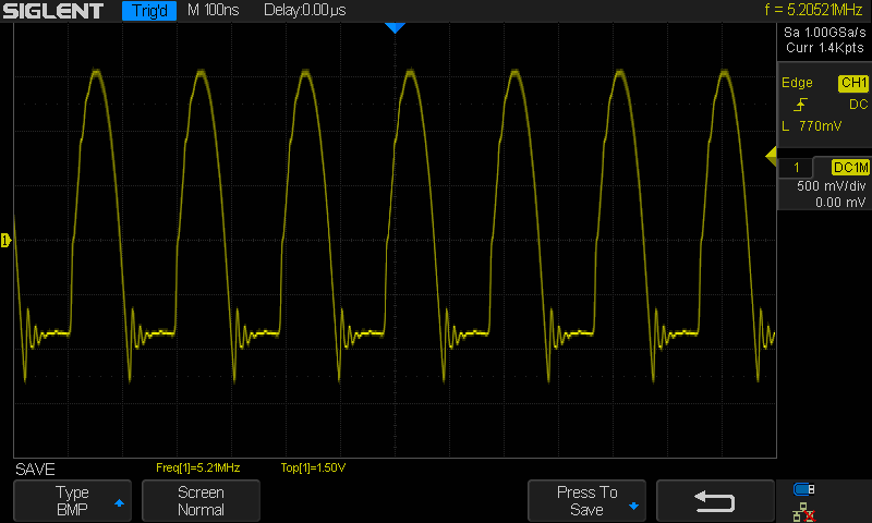

    I looked at my signal with a scope to find out what my signal voltage voltage is. With the drive current set at 1.167mA I get a peak voltage of 1.5V. The signal looks a little weird so I thought it was worth posting.
  • Hi Gerry,
    You shouldn't have ringing on the bottom half cycle of the waveform, although this could be due to your scope. Were you probing near the sensor or the device?
    As for lag or latency, there should be no lag beyond the configured conversion time.
    ChrisO
