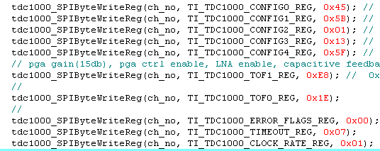

We are currently developing a system that ultra sonic flow meter.
I ask you two questions during the development process.
1. For a long period of time,  As the result of the measurement of TOF values of
 the DOWN STREAM STREAM and UP STREAM STREAM
 Contrary to expectations, we could see that Tup and Tun were looking farther away.
 As shown picture 1 with attached.
 This will cause the flow rate to fall. What's wrong with you
 Please advise.
  picture 1. TOF of Tdn and Tup
2. When the flow rate stops at the ZERO point,  the Tup and Tdn was shook and repeated too.
  What is the reason?
Thanks!!

  • To dear Scott Cummins.
    And thank you, rear it.
    Of course, data can be shared.
    Attached is the TOF file shown below.
    The contents of the file are measured by Tup(UP Stream) and Tdn(DOWN STREAM).
    Again, the flow rate for the first question is Measured data at a constant flow rate of 20 m^3/h.
    There are other measurement data, but measurements are measured with the same result.
    Even though I thought about the effects of temperature, Tup or Tdn changed.
    According to the changing temperature
    I think the graph must to be parallel.

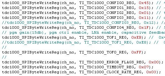

    Additionally, TDC1000 set value.
    TOF_value.xlsx
    Picture#1. CONFIGURE #1
    Picture#2. CONFIGURE #2
    Thank you for your attention!!
