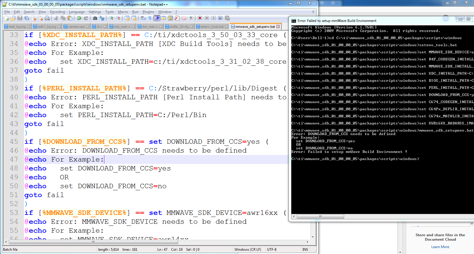

AWR1642BOOST: Unable to set up build environment on windows
Part Number: AWR1642BOOST
PFA
I'm getting an error as DOWNLOAD_FROM_CCS needs to be defined..... screen shot of error is attached.
 I defined set DOWNLOAD_FROM_CCS=yes and also tried defining "no" both are not working.
Vinayak
  • Vinayak,
    The issue could be in the setenv_tools.bat file where you are setting the  "DOWNLOAD_FROM_CCS" . There could be a space when setting this environment variable.
    Please check.

    Raghu
  • Hello Raghu,
    In setenv_tools.bat, there is no space, it is similar to the reference file you have attached. I have installed all dependencies upgraded versions which mentioned in mmwave_sdk release notes.
    My setenv_tools.bat file, drive.google.com/.../view
    Vinayak
  • Is this issue resolved?
    -Raghu
