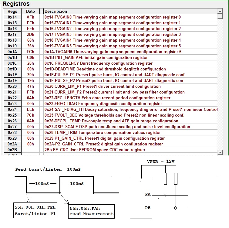

    now I have another problem I do not generate the pulses in PA and PB
    I put pull-up resistors to vpwr, in the outputs PA and PB (I do so to go step by step and commit the least errors)
    I follow the procedure, I set P1, P2, Freq, Lim1 and LIM2
    in the attachment are all records read directly from the PGA460, I also show the sequence that I am following after initializing the register,
    every 100mS I send first burst / listen (55h, 00h, 01h, feh), I wait 100ms and send measurement read command (55h, 05h, FAh), but on oscilloscope I always see the two PA and PB signals high (VPWR)
  • I ALREADY RESOLVED
    THE PROBLEM WAS FAIL TO INITIALIZE AT LEAST ONE OF THESHOLD
    THANKS EVERYONE FOR YOUR HELP
